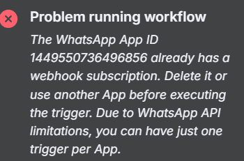

Yesterday I added a whatsapp trigger and a couple of Whatsapp nodes to a workflow.
I tested them and everything worked.
If I try to run the workflow, I get this:
I checked my credentials and they work. I’m using a permanent token.
What can be the problem?
Hi @albertocv ,
Have you authenticated WhatsApp trigger node using Client ID and secret?
if so, then there is no need to setup the webhook in meta developer console.
You’ll need to delete the webhook from there, in order to run the workflow correctly.
I experienced the similar problem earlier and this solved my issue.
Thanks, I didn’t set up a webhook. I just found out that it happens only because I click Execute Workflow in an active workflow.
