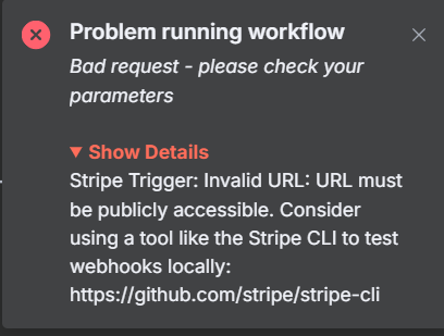

Hi, I’m new with n8n and I’m trying to work with Stripe for some payments.
The thing is that I’ve completed my account within Stripe already so the only thing that last is connect it in n8n.
My node is already connected and credentials done, but I need to tesis it locallysince I’m using a local version.

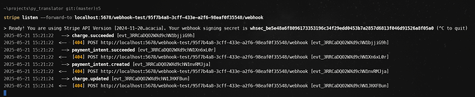

I’ve have also donwnload Stripe cli and execute this command using my local webhook:

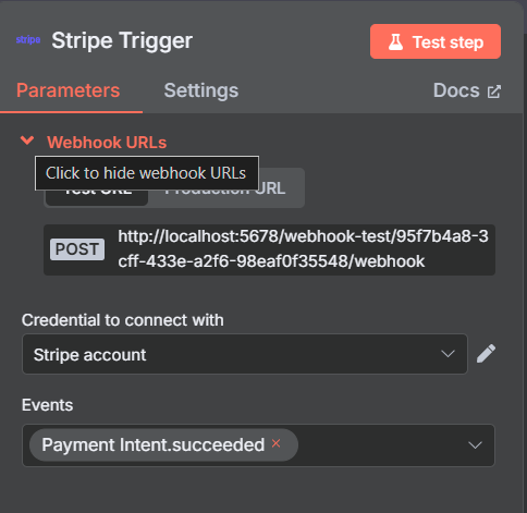

This is the node settings:
I have only a Stripe trigger working

Hi,
The issue is that it’s a localhost URL. If you ran this on n8n cloud it would work. You can read on how to fix this on Docker | n8n Docs
But it’s just recommended for development. I would recommend docker-compose with a domain for production.
Thanks for your response.
At the end I used ngrok in order to give stripe a valid url to my localhost
