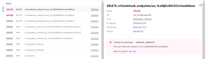

I’m having exactly the same issue!
The Stripe trigger works fine when I have Listen For Event active but then when I try to activate the worksflow I get the error.
In the Stripe logs it show a 404 error:
This is with the Stripe node set to both live or sandbox credentials.
