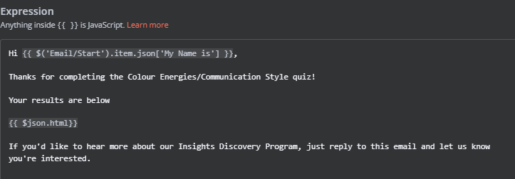

I am trying to have an email send out from the Outlook node,
It looks like this at the moment, and it doesn’t seem to register the new line when I type enter.
Here’s what I have in the email body section

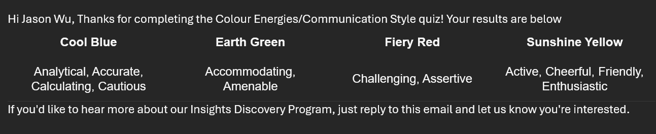

Here’s what the output in the email looks like. I can’t seem to get the new lines to register.

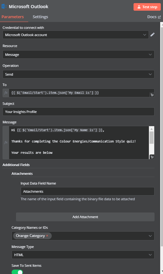

You have the Message Type set to HTML. HTML basically ignores normal whitespace. You could either…
  • Add a <br> tag into your message text wherever you want a new-line (or otherwise control the formatting using HTML tags).
    OR
  • Set the Message Type to Text (…but this might mess up the other content that appears to already be formatted using HTML).
@hubschrauber
Thanks so much! It worked :slight_smile:
