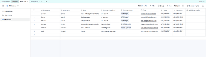

Struggling with making a string correspond to an n8n array
Hey, I’ve seen other people struggle with this airtable/n8n association, but my issue is a bit too specific to be covered already. I’m currently building a business card reader for the company I work at: the agent would extract the data from the card and input it in the CRM. The only issue is with company association: n8n extracts a string but I’d like the agent to use that info to categorise the new contact via a column using list (company copy column) that depends from another table (company list). How to make the agent retrieve the company and associate a string name with the corresponding array element? I have no option in the data extractor to take company as an array. If that’s clear. Thanks! I’m on the web version of n8n.
Expecting an array
