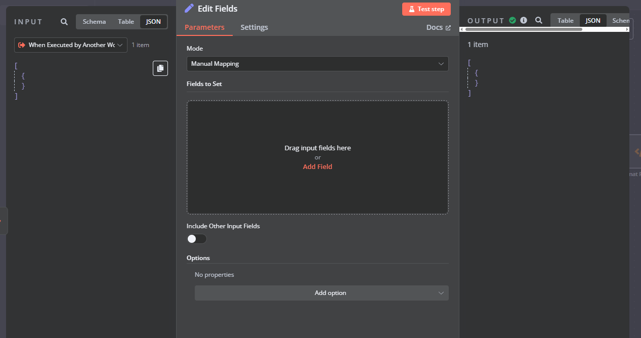

Sub-Workflow doesn't allow to do anything with data
Sub workflow receives data, but it’s impossible to map it, neither with code nor anything, making it unusable, however, if I check execution,n it’s marked as successful but I can’t process it any way.

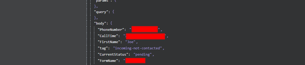

Here you go. Again the problem is that that sub workflow passes the data but I only see it after it’s executed in the Executions but I can’t adjust it in the middle even if I execute main flow step by step.

JSON Is properly formatted. The problem is on the receiving end. Data is received but only when I check execution not in step by step, so I can’t define fields to grab with edit node for example.

Might not fully understand what you’re looking to do but have you tried copy/pasting and pinning data in the output of the “When executed by another workflow” node in the subworkflow and then doing the mapping as you please in the “Edit Fields” node?
Then, when running the subworkflow from the main one it should then work. Don’t forget to unpin though so let the live data go through.
This is what I mean. I took your pinned webhook data and pinned it in the output of the first node in the subworkflow so I can map. Is this what you were looking to do?
yup I pinned it while I was testing and trying to figure out why it’s not going the set fields node.
If you look at my intitial post you will see that a subworklow receives data but in the ouput of this node it’s empty, however when I check executions the data is there.
I believe it’s a bug.
@Niklas_Hatje can you confirm it’s a bug?
I’m currently having the same problem as well. I see the data in the execution, but when I copy it into editor, I don’t see any data.
