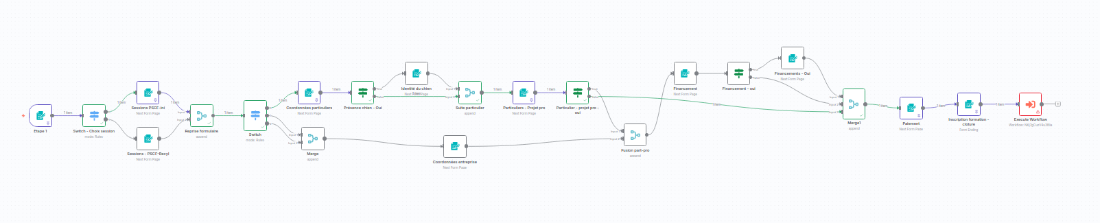

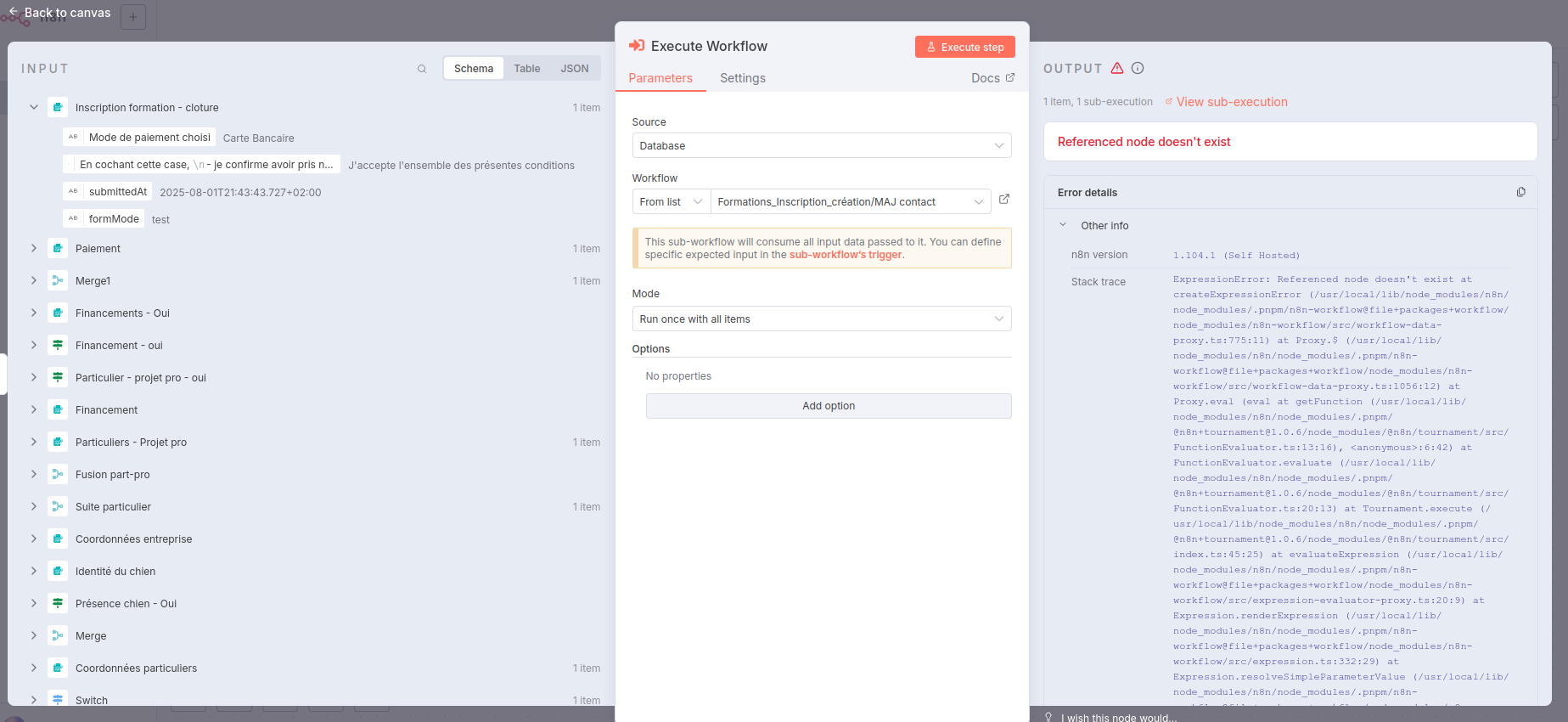

I’m trying to connect two workflows. The first is a form. After submitting it, I want to launch other workflows.
I’m attaching a screenshot of my main workflow (the form) as well as the start of a secondary workflow.

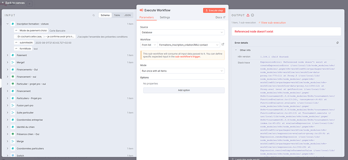

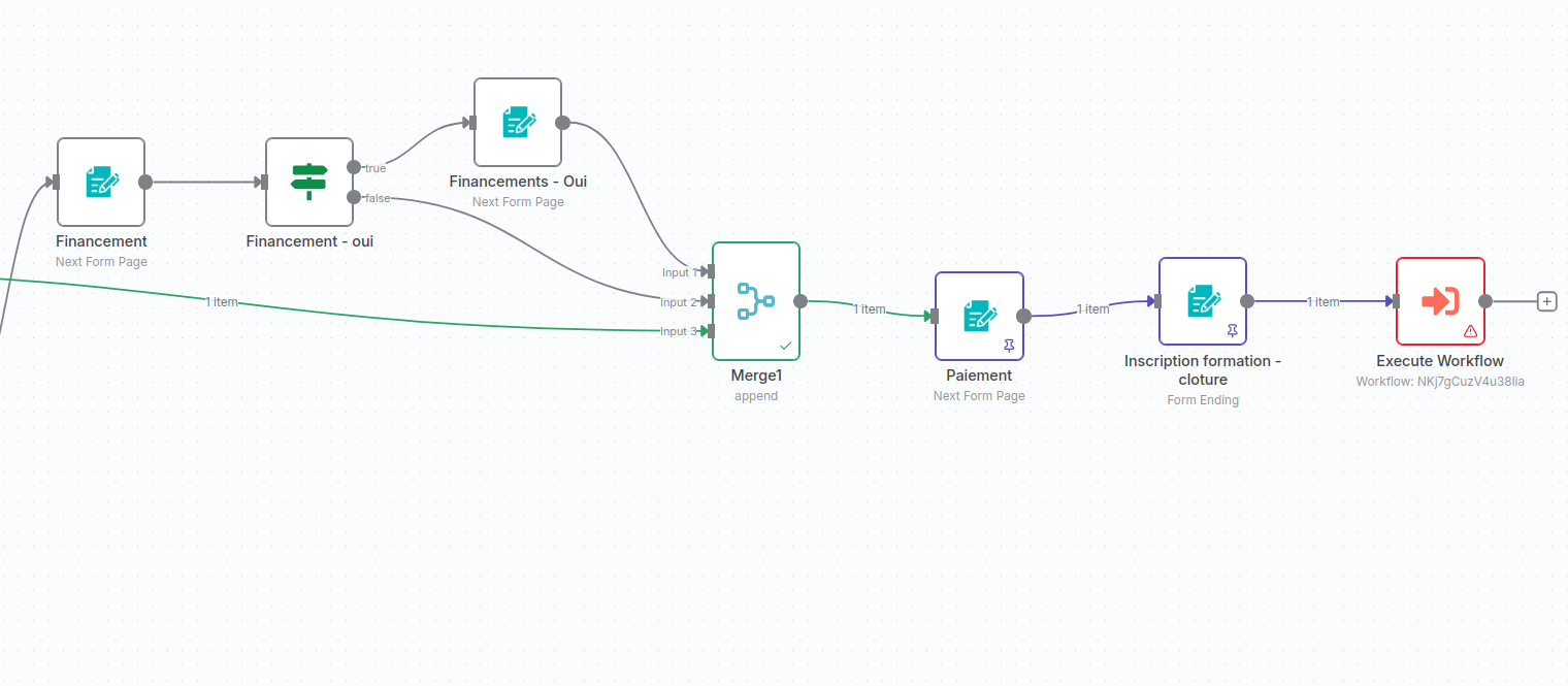

When running, I get the error:
Referenced node doesn’t exist
Error details: Other info

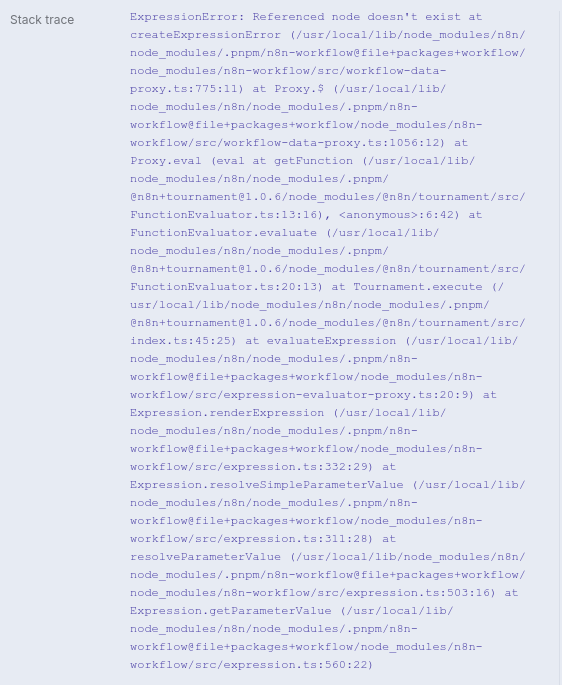

ExpressionError: Referenced node doesn’t exist at createExpressionError (/usr/local/lib/node_modules/n8n/node_modules/.pnpm/n8n-workflow@file+packages+workflow/node_modules/n8n-workflow/src/workflow-data-proxy.ts:775:11) at Proxy.$ (/usr/local/lib/node_modules/n8n/node_modules/.pnpm/n8n-workflow@file+packages+workflow/node_modules/n8n-workflow/src/workflow-data-proxy.ts:1056:12) at Proxy.eval (eval at getFunction (/usr/local/lib/node_modules/n8n/node_modules/.pnpm/@[email protected]/node_modules/@n8n/tournament/src/FunctionEvaluator.ts:13:16), :6:42) at FunctionEvaluator.evaluate (/usr/local/lib/node_modules/n8n/node_modules/.pnpm/@[email protected]/node_modules/@n8n/tournament/src/FunctionEvaluator.ts:20:13) at Tournament.execute (/usr/local/lib/node_modules/n8n/node_modules/.pnpm/@[email protected]/node_modules/@n8n/tournament/src/index.ts:45:25) at evaluateExpression (/usr/local/lib/node_modules/n8n/node_modules/.pnpm/n8n-workflow@file+packages+workflow/node_modules/n8n-workflow/src/expression-evaluator-proxy.ts:20:9) at Expression.renderExpression (/usr/local/lib/node_modules/n8n/node_modules/.pnpm/n8n-workflow@file+packages+workflow/node_modules/n8n-workflow/src/expression.ts:332:29) at Expression.resolveSimpleParameterValue (/usr/local/lib/node_modules/n8n/node_modules/.pnpm/n8n-workflow@file+packages+workflow/node_modules/n8n-workflow/src/expression.ts:311:28) at Expression.getParameterValue (/usr/local/lib/node_modules/n8n/node_modules/.pnpm/n8n-workflow@file+packages+workflow/node_modules/n8n-workflow/src/expression.ts:522:16) at ExecuteContext.getNodeParameter (/usr/local/lib/node_modules/n8n/node_modules/.pnpm/n8n-core@file+packages+core@[email protected]_@[email protected]_46e522f8a77ed5eccc0991bfcca21502/node_modules/n8n-core/src/execution-engine/node-execution-context/node-execution-context.ts:367:37)
Thank you in advance for your help.

If you look at the execution logs for each workflow - did the second one even started? Which node errored out? Can you attach the workflows here for us to take a look?

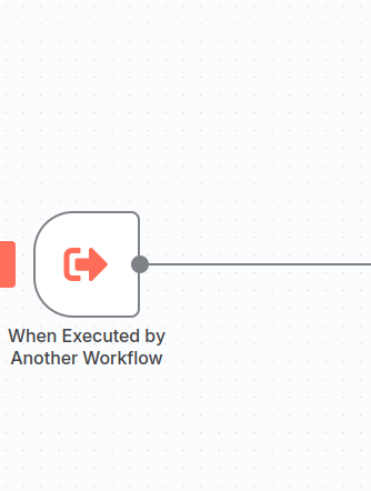

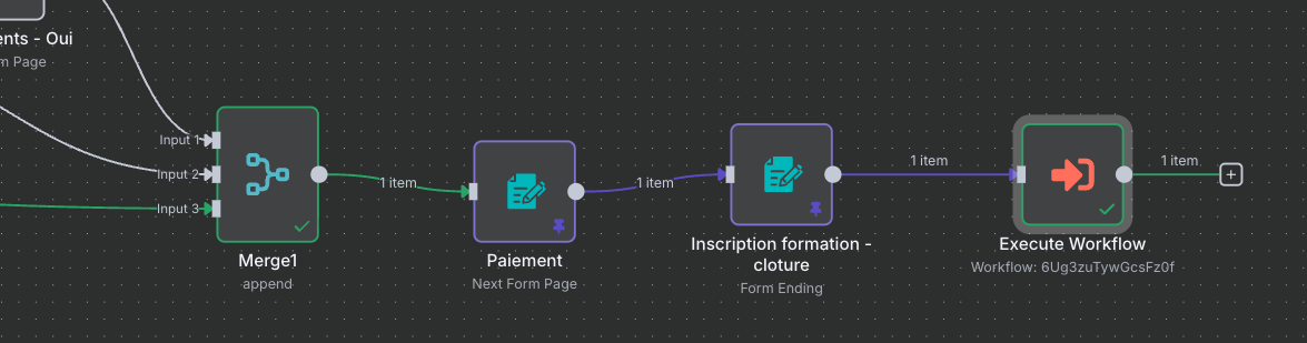

Here are my two workflows.
After rereading the documentation, the sub-workflow runs fine, but there is no data.
My “Formation_PSCF_Inscription” workflow is my registration form. I built it this way because I have a complex registration process.
The second workflow is intended to register the items in my baserows database.
Thank you for your help.

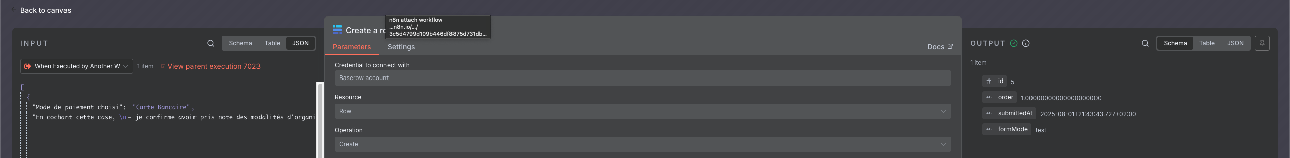

Hey @Cheun_Apan hope all is good, no worries, I am glad you had time to relax and hopefully had some good time.
I understand you recovered from the problem where you have been referencing the node which doesn’t exist. Now, the new issue appears to be around returning data from the subflow to the main flow.
Base on what you mentioned above, “the second workflow is intended to register the items in my baserows database”, meaning insert data. The issue is that even though the sub-workflow runs fine", “there is no data” returned.
What data is expected to be returned? I ran this for my database (thank you for pinning some data) and it appears that the data was inserted (I only used submittedAt and formMode though). Could you explain what do you see when the flow runs and what do you expect instead?
