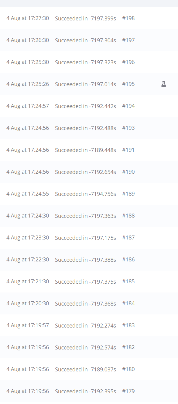

Hi there,
After database migration to postgres, “Succeeded in” displays incorrect values

I checked the values in the execution_entity table
This looks like a time zone problem
startedAt saves in my local time zone(UTC +2) and stoppedAt saves in UTC

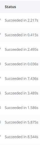

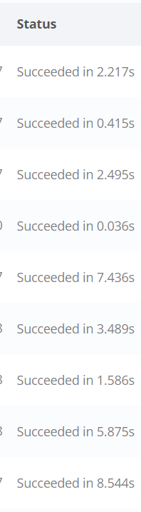

I recently upgraded n8n to version 1.1.1 and switched EXECUTIONS_MODE to queue.
Now Succeeded in displays valid values.
