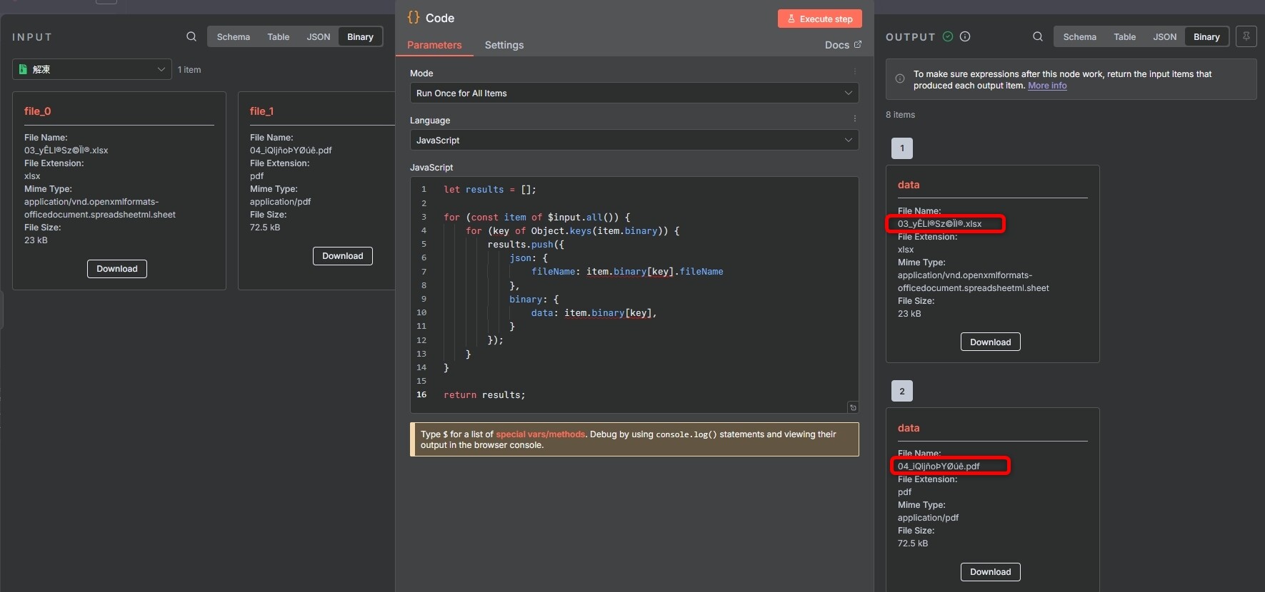

Check out this example:

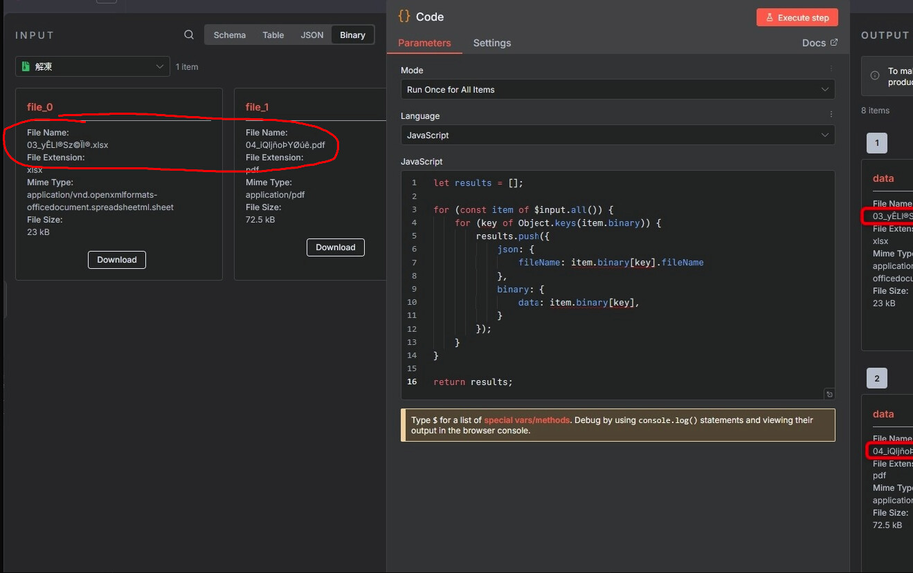

but file title changed unreadable name.
i think Because of Japanese title.
Do you know how to keep Japanese title ?
I see on the left side that it actually changed on the previous step.
I don’t believe you can keep the original names if they were in Japanese while using the default Compression node.
