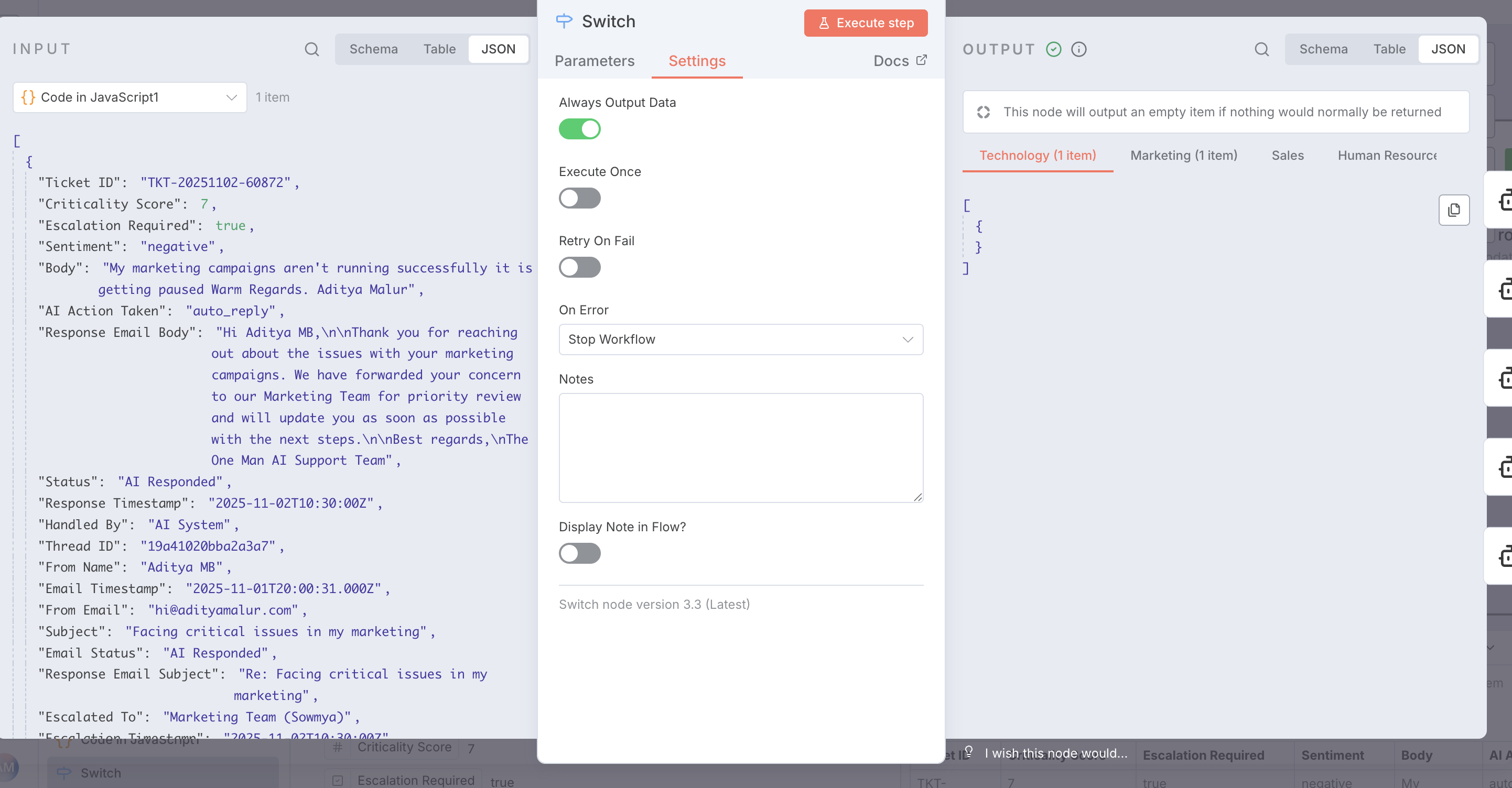

Switch Node "Always Output Data" Bug - Routes to First Output Regardless of Conditions
Description
Problem

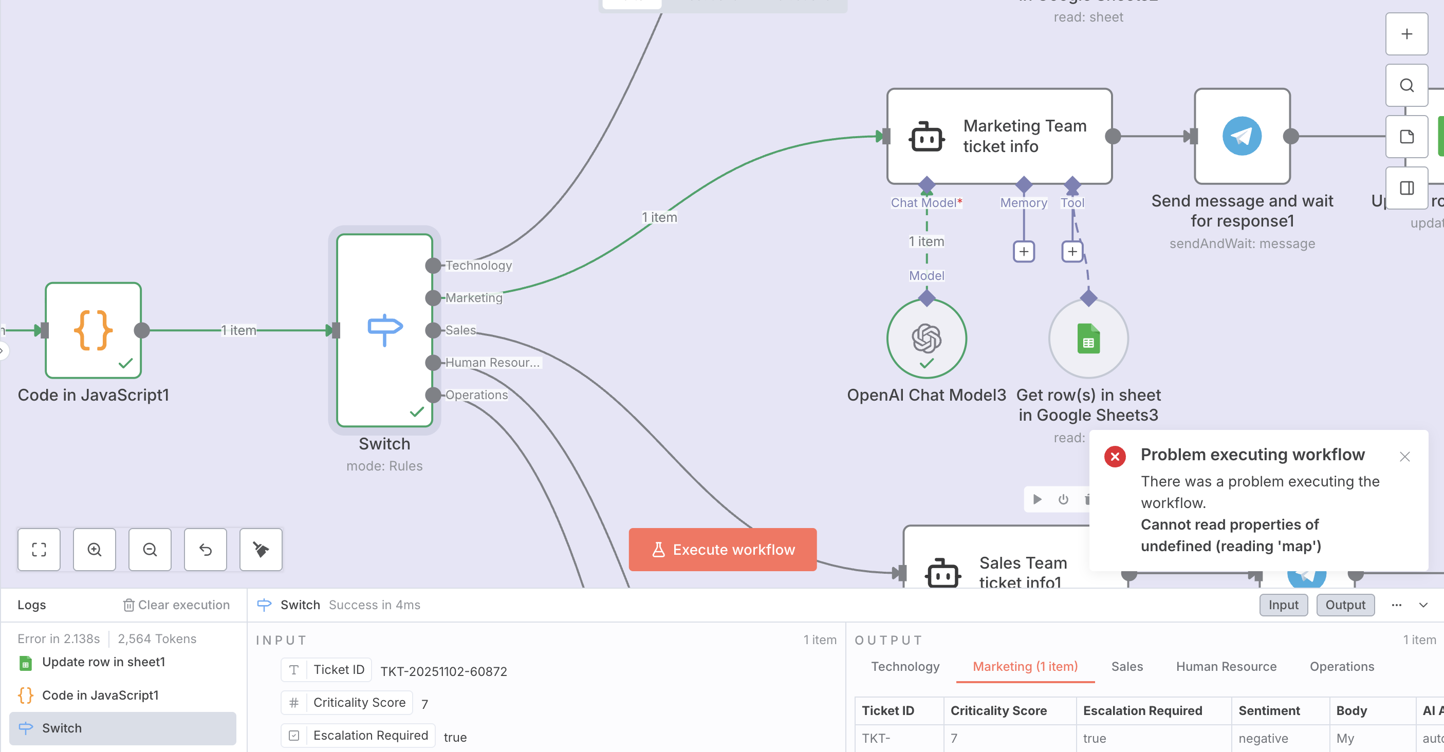

Switch node sends data to Output 1 every time, even when conditions clearly match different outputs (e.g., Output 2 for Marketing).
Environment
  • n8n version: [Your version]
  • Node: Switch (v3.3)
Expected vs Actual
Data:
json
"Escalated To": "Marketing Team (Sowmya)"
Expected: Routes to Output 2 (Marketing condition matches)
Actual: Routes to Output 1 (Technology) - WRONG
Configuration
  • :white_check_mark: Always Output Data: Enabled
  • :cross_mark: All Matching Outputs: Disabled
  • Mode: Execute First Matching Output
  • Conditions: Exact string matching on “Escalated To” field
What I’ve Tried
  • Disabled “All Matching Outputs” explicitly
  • Verified no whitespace issues
  • Used strict type validation
  • Manually set "allMatchingOutputs": false in JSON
  • Added debug logging - data is correct
When “Always Output Data” is disabled: Switch works correctly but doesn’t output data when no match (need this for error handling).
Current Workaround
Using 5 parallel Filter nodes instead of Switch.
Question
Is this a known bug with “Always Output Data”? Any fix or recommended alternative for reliable multi-output routing?
Screenshots attached showing:
Can you share the conditions for the switch node ? I do believe that you need to adjust the conditions in the switch node.
