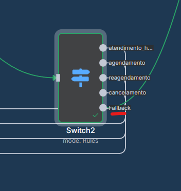

Switch not properly working
I have a switch that checks for specific strings the AI Agent can output. It outputs the strings as expected, I have a SET node that puts it as a string and then it goes to the Switch (code below), but it always goes to the fallback.
I do not have the option for “Less strict type validation” and I’m kind of lost why it’s not working.
No error - but it goes to fallback every time.
(https://testdevocto.app.n8n.cloud/workflow/0biHZDRZmfzb49y5)

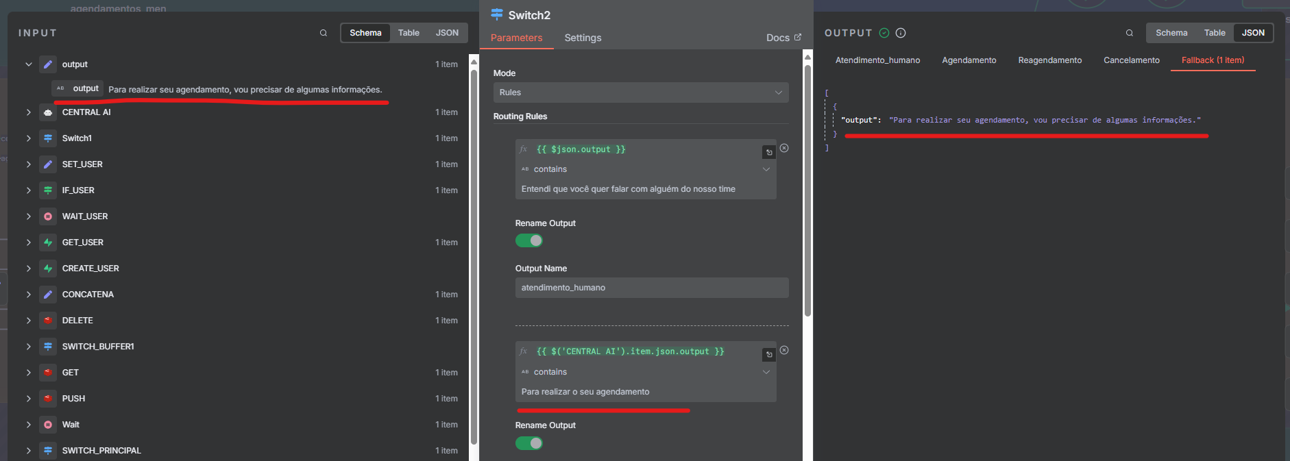

## Share the output returned by the last node
It returns exactly the output:
    "output": "Para realizar seu agendamento, vou precisar de algumas informações."
and yet, it's not caught by the first switch rule.
## Information on your n8n setup
- **n8n version:** 1.102.3
- **Database (default: SQLite):** SQLite / Supabase
- **n8n EXECUTIONS_PROCESS setting (default: own, main):** main
- **Running n8n via (Docker, npm, n8n cloud, desktop app):** n8n cloud
- **Operating system:** Windows 11
See here how I set the rule:
Para realizar o seu agendamento
is not equal to
the first phrase has “o” in the middle.
