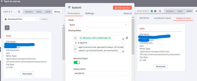

Hi,
I’ve set up a switch to run certain routes depending on the input binary file’s MIME type. However, for the PPTX route below, it doesn’t seem to run even though the condition is met, and instead goes to the fallback route.
Is there anything wrong here?
Thank you!

You were right, I had one extra space in the binary.data.mimeType box to the left of the ‘{{’.
Thanks!
