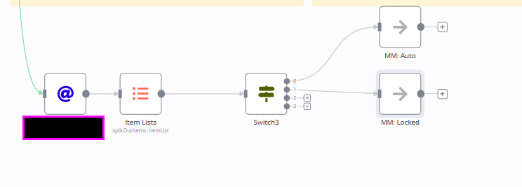

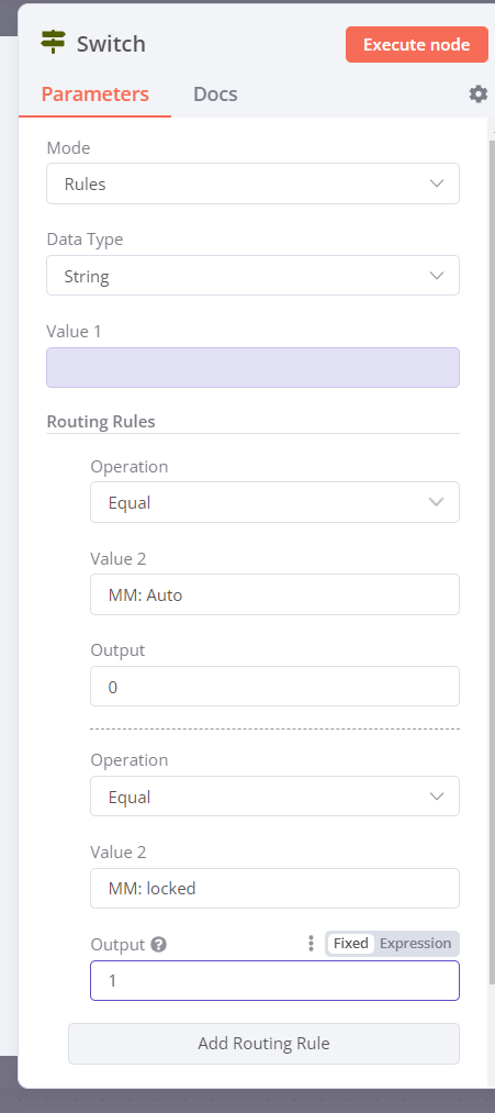

couldn’t you use a Switch Node and map all 3 tags as value 1.
Here is my example workflow.
i didnt think you were able to use more than one tag in there?
I’ll try it and let you know
