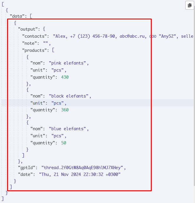

There is an array of json data, it needs to be transmitted unchanged in a text message to telegram. In the telegram, the user responds with the message “YES” and this array should get into the telegram trigger node with the same json array.

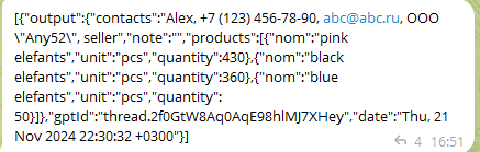

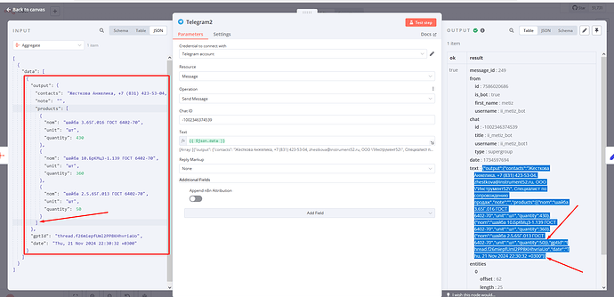

But when executing the node, the characters ] are lost and, accordingly, it is impossible to process the data as a json array.
Why is this happening and how to make sure that the data is transmitted unchanged.

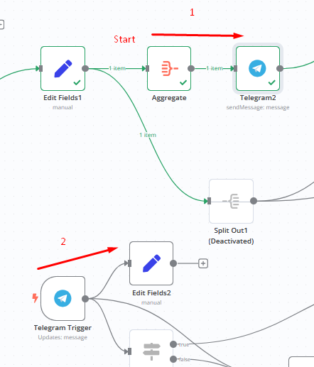

We need such a scheme:
json → telegram → user response → telegram → json

Added 2 processes: one with {{ $json.data }}, another with {{ JSON.stringify($json.data) }}. The result is the same - “]” is lost.

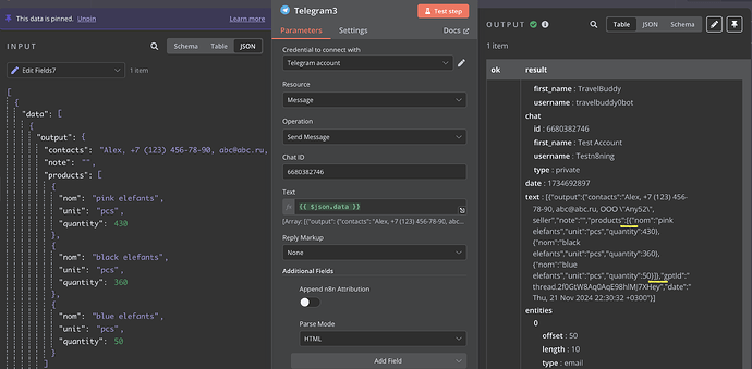

Hi @koordinator7
I tried to reproduce this but both scenarios work for me, the products array keeps the ]
or am I missing something?
Thanks, ria.
Helped parse mode HTML. Markdown mode does not work correctly. Where can I read about these modes?
If we send this data json to the telegram chat, we get a text in one line, it is difficult to read.
json-text1
How to get the information in a convenient form?
