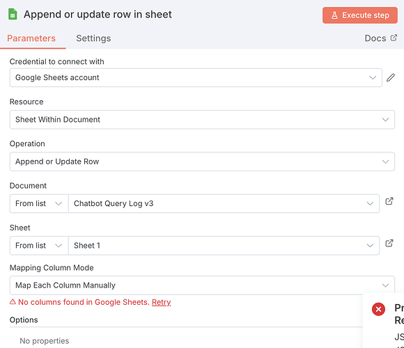

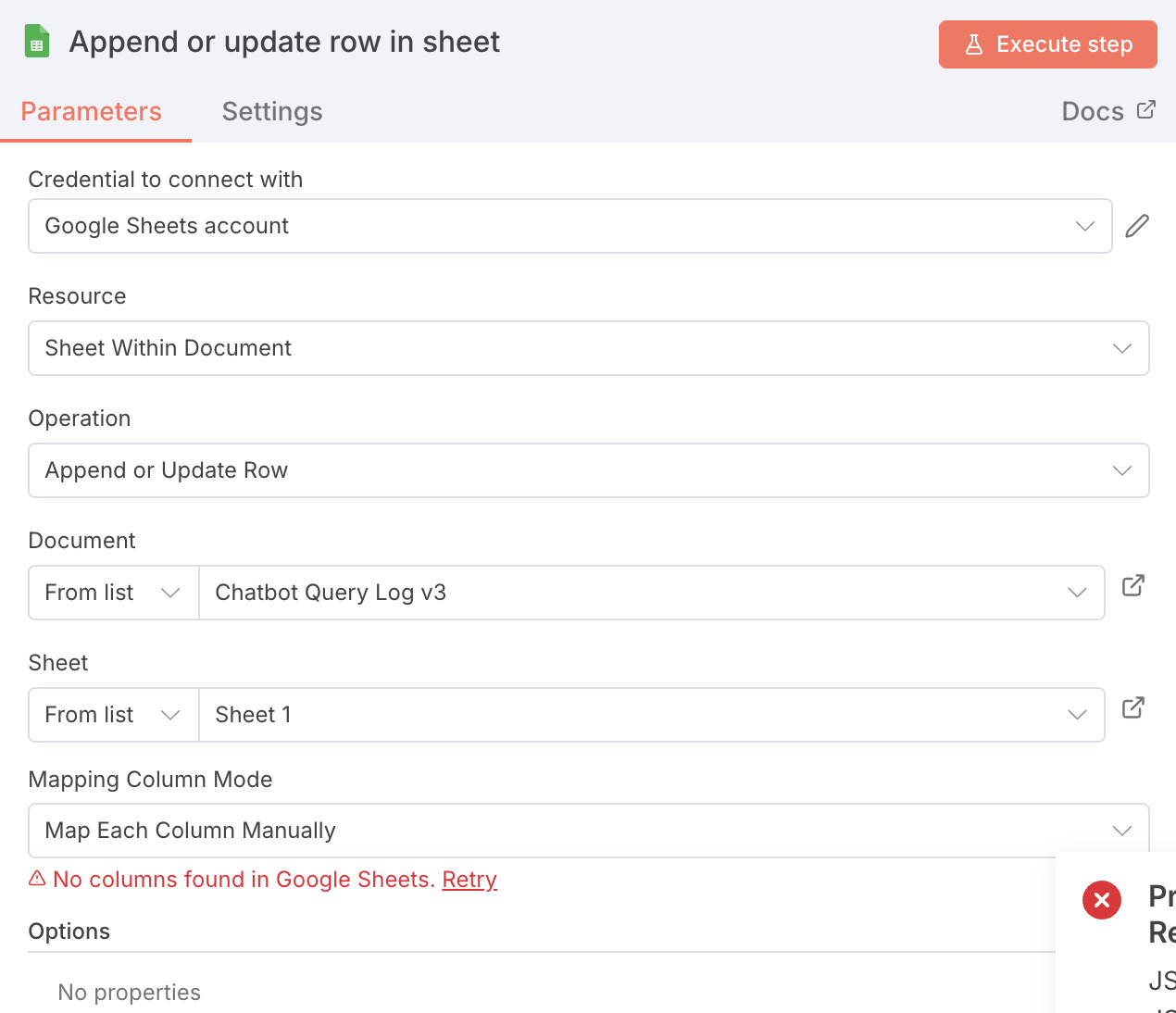

i’m trying to use the google sheets, integration. Part of it is mapping the various columns, but the node isn’t letting me do that. When I go to map manually, it says: No columns found in Google Sheets. Retry. Retrying doesn’t help. it’s simply not reading the columns I have put into google sheets ( yes I have refreshed).
Any ideas? Thanks so much!!

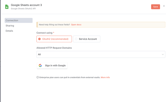

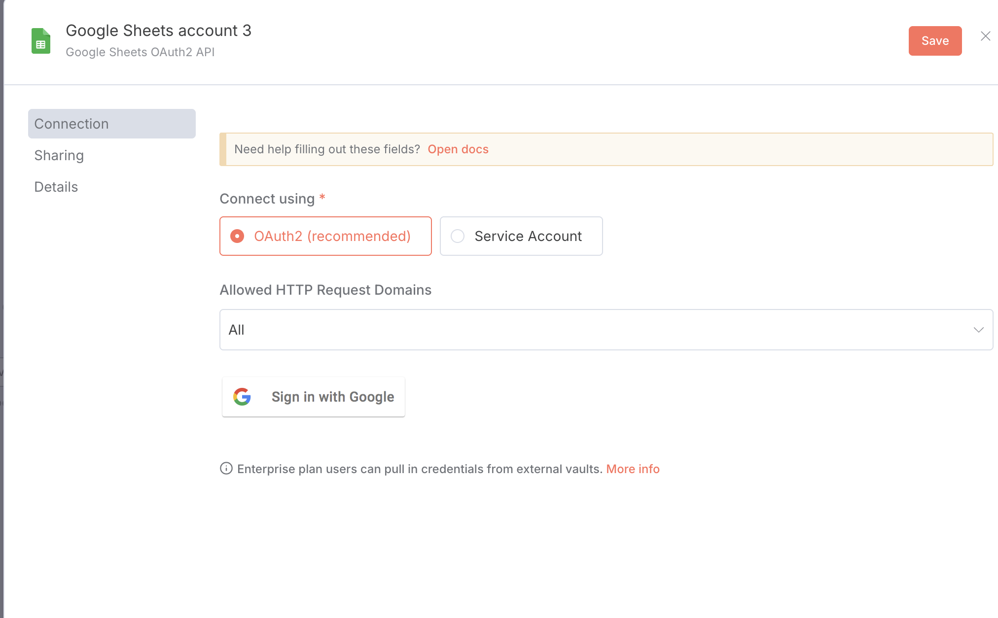

Thanks. When i go to create a new credential this URL isn’t available. See screenshots (first is from video, second is what I’m seeing when creating a new credential)
Ok so Claude is telling me the reason I don’t see the URL is “Your using OAuth2 (recommended) which handles everything automatically - you don’t need to manually set up Google Cloud!”
You have to set the webhook url (not the https://localhost , you will need a public URL not localhost with your n8n instance), in the google account.
Then, yes you can click that oauth2 button.

Here are the most likely solutions to fix the “No columns found” error:
  • Add a Header Row: Ensure the very first row in your “Sheet 1” contains titles for each column. This is the most common cause of this error.
  • Refresh the Schema: After adding headers, click the “Retry” link. You may also need to re-select the specific sheet from the dropdown menu to force the tool to check for the columns again.
  • Check Permissions: Try re-authenticating your Google Sheets account within the tool. The connection might have expired or lack the necessary permissions to read the sheet structure.
  • Verify the Correct Sheet: Double-check that your data and header row are in the exact document (“Chatbot Query Log v3”) and sheet (“Sheet 1”) selected in the node.
