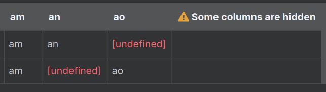

When handling with data with multiple columns, and the number of columns on each item is different, the last visible column on table view can show undefined when data actually exists.
In my example, there are two items with properties ranging from a - z and aa-ao, so 41 properties in total. The difference between them is that the 2nd item doesn’t have the “an” property, so it has only 40 properties. In this case the table view shows undefined on ao property in item 1, even though it has the ao property set with value ao.
This does not affect JSON visualization or the actual workflow, only the table visualization.
First item is incorrect in table view (shows ao as undefined):
JSON view is correct:

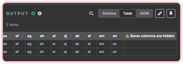

EDIT: pinned the data so the bug is clearly visible.
Full output (the output is correct, only the table visualization is incorrect):

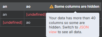

Hi @miguel-mconf
I believe this behavior is intended by design.
Please read the hint:
Hey, thank you for your reply, but this is most certainly not the intended behavior.
I’m very familiar with the hidden columns mechanism, I’ve being using it for years now.
ao column shows value undefined, which is wrong, as it should show ao just like the line below…
I mean it’s probably a UI/front-end issue…

Actually, there isn’t a UI/front‑end issue.
I took another look and noticed you’re not returning the same number of items:
You’re missing this key:
"an":"an"
So the undefined result actually makes sense in the table view.
If you add this key, bringing the total to 41, it looks correct:

If you compare the “JSON” and “table” views for the first item, I’m sure you’ll find the value for ao is inconsistent for the first item.
I’m 100% confident it is a UI issue at this point.

Yes, the an key is only present at the first item. That’s what triggers the bug. If the items have the same number of keys, the bug doesn’t occur. But the issue is not with this key, but with the key ao, which is present in both items, but doesn’t appear on the table visualization for the first item.
Please focus on the key ao and it will become clear.
