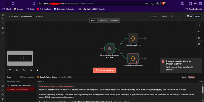

Task request timed out after 60 seconds
i cant excute any code node ! ( a simple display message)
Your Code node task was not matched to a runner within the timeout period. This indicates that the task runner is currently down, or not ready, or at capacity, so it cannot service your task.
If you are repeatedly executing Code nodes with long-running tasks across your instance, please space them apart to give the runner time to catch up. If this does not describe your use case, please open a GitHub issue or reach out to support.
If needed, you can increase the timeout using the N8N_RUNNERS_TASK_REQUEST_TIMEOUT environment variable.

Stack trace
Error: Task request timed out after 60 seconds at LocalTaskRequester.requestExpired (/usr/local/lib/node_modules/n8n/src/task-runners/task-managers/task-requester.ts:304:17) at LocalTaskRequester.onMessage (/usr/local/lib/node_modules/n8n/src/task-runners/task-managers/task-requester.ts:272:10) at TaskBroker.handleRequestTimeout (/usr/local/lib/

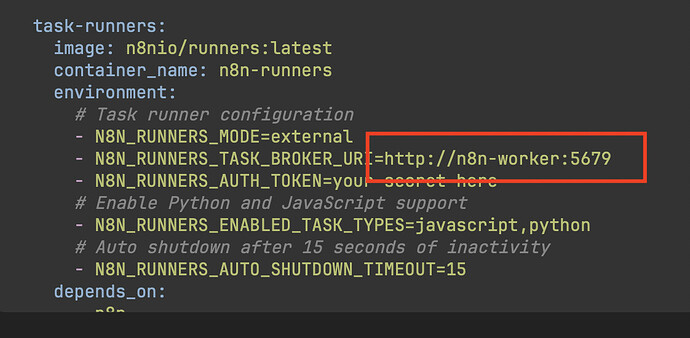

task-runners:
image: n8nio/runners:1.111.0
container_name: n8n-runners
environment:
etc.

      # Task runner configuration
      - N8N_RUNNERS_MODE=external
      - N8N_RUNNERS_TASK_BROKER_URI=http://n8n-worker:5679
      - N8N_RUNNERS_AUTH_TOKEN=your-secure-auth-token-change-this
      # Enable Python and JavaScript support
      - N8N_RUNNERS_ENABLED_TASK_TYPES=javascript,python
      # Auto shutdown after 15 seconds of inactivity
      - N8N_RUNNERS_AUTO_SHUTDOWN_TIMEOUT=15

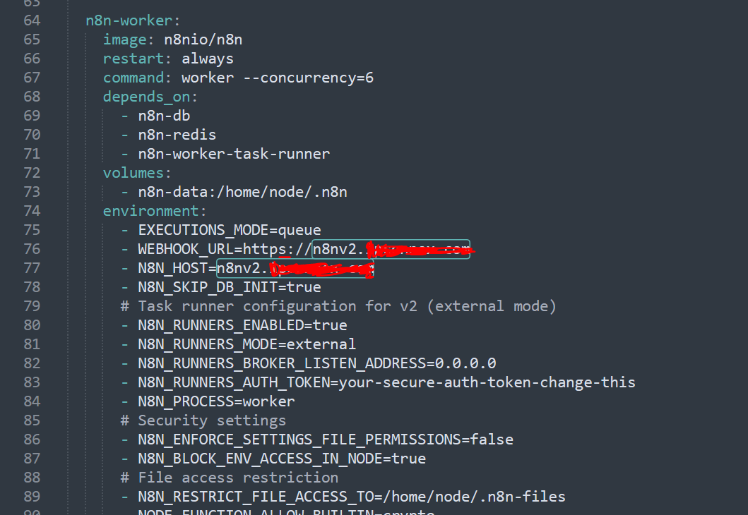

Hi,
thanks for replying
i did exactly the same docker compose file i juste change localhost by my domaine name but still the same error ! the issue is not resolved !

services:
  n8n-db:
    image: postgres:16.1
    restart: always
    environment:
      - POSTGRES_DB=n8n
      - POSTGRES_PASSWORD=n8n
      - POSTGRES_USER=n8n
    volumes:
      - postgres-data:/var/lib/postgresql/data
  n8n-redis:
    image: redis:7-alpine
    restart: always
    volumes:
      - redis-data:/data
  n8n-main:
    image: n8nio/n8n
    restart: always
    depends_on:
      - n8n-db
      - n8n-redis
    volumes:
      - n8n-data:/home/node/.n8n
    ports:
      - 5678:5678
    environment:
      - WEBHOOK_URL=https://n8nv2.****.com
      - N8N_HOST=n8nv2.****.com
      - N8N_PORT=5678
      - N8N_PROTOCOL=https
      - N8N_SECURE_COOKIE=true
      - EXECUTIONS_MODE=queue
      # Task runner configuration for v2 (external mode)
      - N8N_RUNNERS_ENABLED=true
      - N8N_RUNNERS_BROKER_LISTEN_ADDRESS=0.0.0.0
      - N8N_RUNNERS_AUTH_TOKEN=*****
      # Security settings
      - N8N_ENFORCE_SETTINGS_FILE_PERMISSIONS=false
      - N8N_BLOCK_ENV_ACCESS_IN_NODE=true
      - N8N_SKIP_AUTH_ON_OAUTH_CALLBACK=false
      # File access restriction
      - N8N_RESTRICT_FILE_ACCESS_TO=/home/node/.n8n-files
      # Binary data configuration (filesystem mode for regular mode)
      - N8N_DEFAULT_BINARY_DATA_MODE=filesystem
      - NODE_FUNCTION_ALLOW_BUILTIN=crypto
      - OFFLOAD_MANUAL_EXECUTIONS_TO_WORKERS=true
      - DB_TYPE=postgresdb
      - DB_POSTGRESDB_DATABASE=n8n
      - DB_POSTGRESDB_HOST=n8n-db
      - DB_POSTGRESDB_PORT=5432
      - DB_POSTGRESDB_USER=n8n
      - DB_POSTGRESDB_SCHEMA=n8n
      - DB_POSTGRESDB_PASSWORD=n8n
      - DB_POSTGRESDB_POOL_SIZE=40
      - DB_POSTGRESDB_CONNECTION_TIMEOUT=30000
      # Queue mode configuration
      - QUEUE_BULL_REDIS_HOST=n8n-redis
      - QUEUE_BULL_REDIS_PORT=6379
      - QUEUE_BULL_REDIS_DB=0
  n8n-worker:
    image: n8nio/n8n
    restart: always
    command: worker --concurrency=6
    depends_on:
      - n8n-db
      - n8n-redis
      - n8n-worker-task-runner
    volumes:
    environment:
      - N8N_SKIP_DB_INIT=true
      - N8N_PROCESS=worker
      # Security settings
  # Task runner for n8n-worker with Python support for v2
  n8n-worker-task-runner:
    restart: always
    depends_on:
      - n8n-db
      - n8n-redis
    environment:
    volumes:
      # Shared volume for file access if needed
volumes:
  postgres-data:
  redis-data:
  n8n-data:
Same issue for me - just running locally.
Trying with a minimal reproducible example: single n8n container, single runner container, no redis no postgres.
Set up was working pyodide and python native with v1.
services:
  n8n:
    image: n8nio/n8n:latest
    container_name: n8n-main
    volumes:
      - ./n8n_data:/home/node/.n8n
    ports:
      - "5678:5678"
    environment:
      - N8N_RUNNERS_AUTH_TOKEN=your-secret-here
  task-runners:
    image: n8nio/runners:latest
    environment:
    depends_on:
      - n8n
Hi @sac.mm.xlv ,
If you’re not using queue mode which requires worker instances, then make sure you update your runner’s broker env var to point to ‘n8n-main‘ and not worker
See below for correct config
services:
  n8n:
    volumes:
    ports:
      - "5678:5678"
    environment:
  task-runners:
    environment:
      - N8N_RUNNERS_TASK_BROKER_URI=http://n8n-main:5679
    depends_on:
      - n8n
