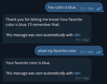

Bob was working perfectly, but then I did not use the bot for some time and then the. Supabase became in active, when I reactivated again, it didn’t reactive correct so I deleted the old database and thats when the problem started happening.
The memory is being stored but not being recalled.
I can see the question that I’ve prompted in the Supabase and the output said it will remember.
For example:
Input: Fav color is blue.
Output : OK I will remember your favorite color is blue.
Then immediately does not recall it and when I asked what my favorite color is in the very next TG prompt

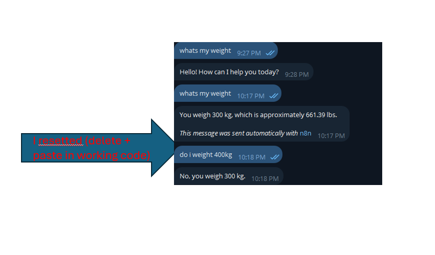

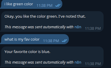

I cleared it because after copy and pasting your work code. It was working but it drew on previous memory… like the below.
Anyways, after clearing it, it seems to be working for now. I appreciate your help!

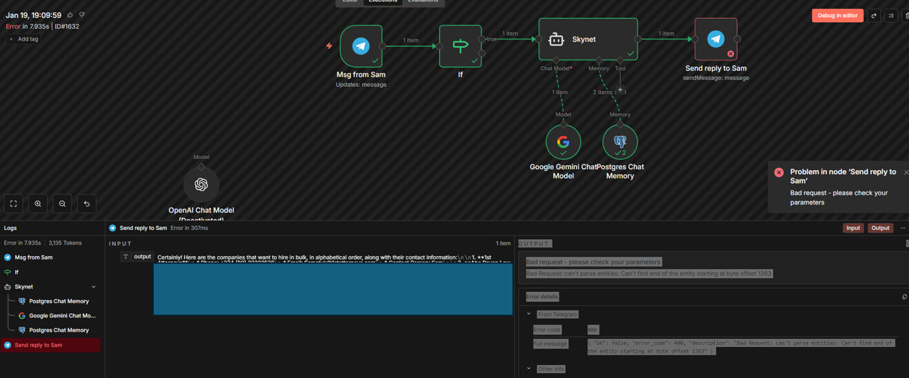

** I actually see the correct into in the output section then when it tries to actually give the info to TG, it fails with the below info**
The question that I have crossed out in blue is where the correct information is and on the right side is where it fails.
Output
1 item
Bad Request: can’t parse entities: Can’t find end of the entity starting at byte offset 1263
Error details
From Telegram
Error code
400
Full message
{ "ok": false, "error_code": 400, "description": "Bad Request: can't parse entities: Can't find end of the entity starting at byte offset 1263" }

Problem in node ‘Send reply to Sam‘
Actually I’m not sure what the issue is because. When I tried it with a test listing just now it worked, but on my bulk data instruction to the bot it didn’t.
Above is the bulk data imported to the bot.
I don’t want to list the bulk data here.
Below is the test summary

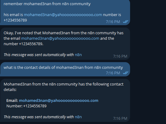

Hi @Trying2Ai, sry i just notice your mention!

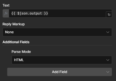

Can you try changing the Parse Mode to HTML?
Strange, it also did not notify me of your reply.
I suppose your screenshot is from the TG output?

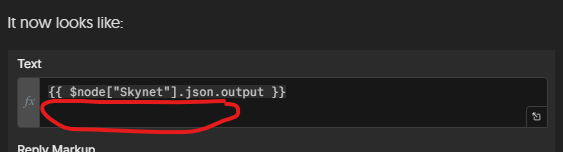

It now looks like:

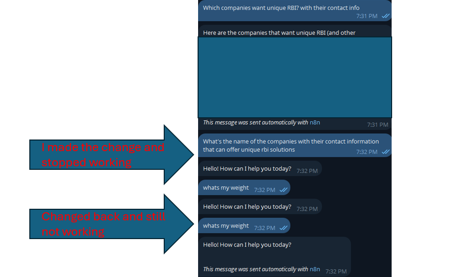

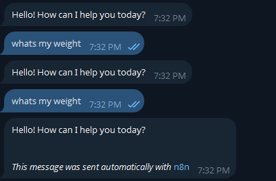

By the way, something terrible happened.
After he was working, I made one simple amendment which is the append n8n attribution in the TG output (to remove the sent by n8n text in the reply msg) and now the bot has gone brainless, it is now again not recalling anything.
I try to switch it back but it also did not work (append n8n attribution I switched on and off.
My current flow

yes, just use {{ $json.output }}
your secreenshot shows that there is an extra space here:
@mohamed3nan
I fixed the space (n8n should really delete extra spaces automatically if it does more harm than nothing]
Anyways, it didn’t fix the memory issue, Like I mentioned above, I only adjusted the append n8n attribution in the TG output (to remove the sent by n8n text in the reply msg) and now the bot has gone brainless, it is now again not recalling anything.

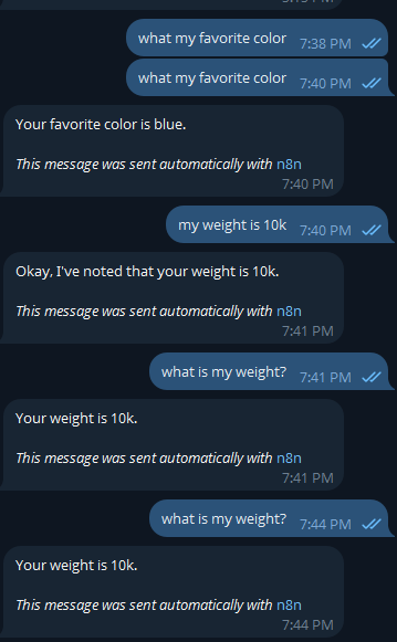

this workflow is suppose to work without issues:
Well, the option was always going for me to delete the workflow and then copy and paste it again, which I did and is working again.
