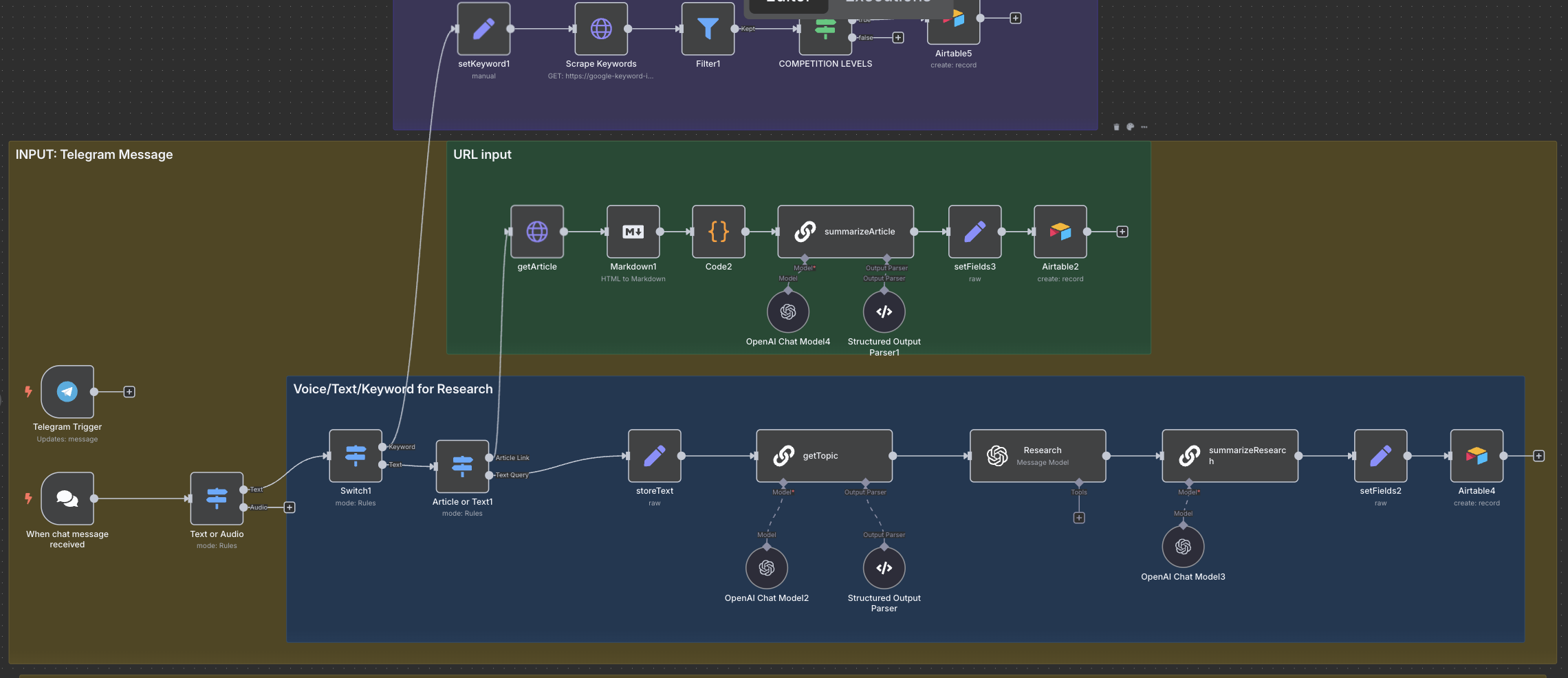

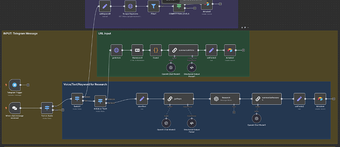

Maybe I am not completely clear. Here is the workflow.
What happens is I send a message to a telegram bot for example keyword IT. The workflow is then started and will research this keyword. I can also do this with an http website. If I go to my bot in telegram that I have made and I send a url in the bot then the trigger will start. Hence trigger on message.

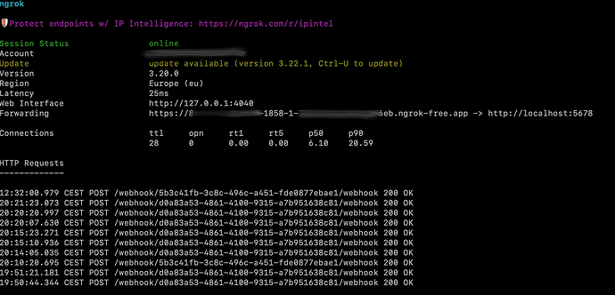

A similar setup on my side is with ngrok adress pointing to my n8n installation running in Docker works fine in Prod and Test
INIT:
ngrok http http://localhost:5678
Then the Telegram API needs to be informed
you can use:
Replace [yourid] with the BOT id and [ngrokIP] with the provided url from ngrok
https://api.telegram.org/bot[yourid]/setWebhook?url=[ngrokIP]
And you will have to spin up your docker container with the same url
Example:
docker run -itd \
 --name n8n \
 --restart always \
 --network inside_network \
 -p 5678:5678 \
 -e GENERIC_TIMEZONE="Europe/Amsterdam" \
 -e TZ="Europe/Amsterdam" \
 -e WEBHOOK_TUNNEL_URL="[ngrokurl]/" \
 -e WEBHOOK_URL="[ngrokurl]/" \
 -v n8n_data:/home/node/.n8n \
docker.n8n.io/n8nio/n8n:latest
So now if you activate your n8n WF and send a message from the BOT the n8n WF will be triggered.
