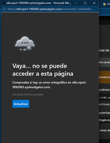

help, when logging in after entering the credentials and secret, it throws an error, it happens with everything, google sheets, excel and many more, I don’t know how to solve this problem

For OAuth2 (Google Sheets, Excel, etc.) to work, the “Redirect URI” must be a valid, publicly reachable URL. Because your domain is not resolving to an IP address, the browser fails to load the page after you enter your credentials.
Before changing anything in n8n, you must make the domain actually exist.

Hi, it’s me again, I still have problems, I think it’s because the n8n page that I opened from hostgator shows that it’s not secure: as you can see in the image, I still can’t do anything, and I can’t find a solution anywhere

This is expected. How do you run n8n?
Hi, I managed to do everything you told me to do, but the problem of not being able to connect the accounts I want to connect keeps happening. Also, when I access n8n from Hostgator, it says the page is not secure.
No, you did not. Otherwise I would be seeing this
and not this
You still did not answer my question
Without sufficient context, you will always be stuck.
Please follow the instructions exactly and highlight any issues encountered along the way.
Claiming to do “everything” when you did not will not help you
