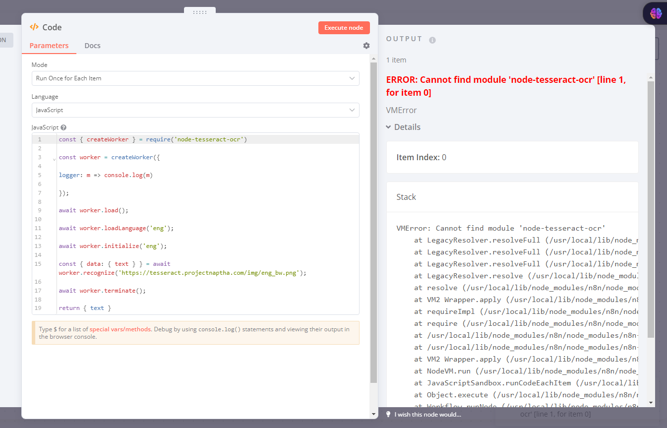

how can i use tesseract on n8n
I use n8n self hosted in docker swarm and I’m in version 1.1.1
and added this variable in my env
- NODE_FUNCTION_ALLOW_EXTERNAL=moment,lodash,moment-with-locales,node-tesseract-ocr

Got it, I installed it directly on the machine, @jan would you be able to help me install it correctly? first time I try to do this using external node.
