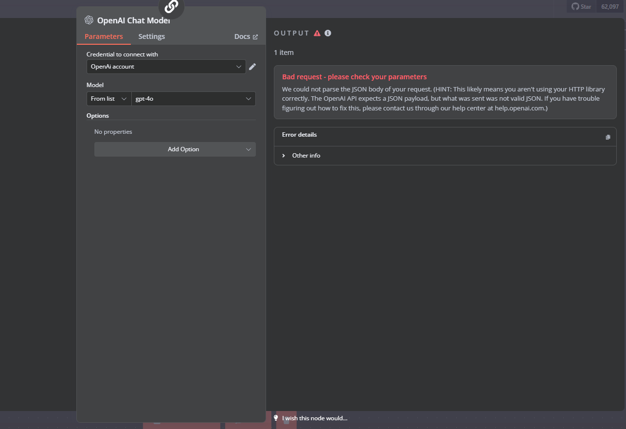

Test Workflow works fine, Production causes GPT node error could not parse the JSON body
Basically having this issue only when in production which is strange, and it only started recently

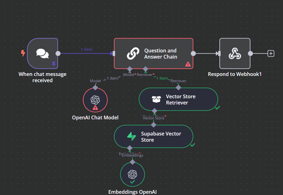

Workflow Code

I was up to date with my main n8n instance, but my worker instance was 8 weeks behind which was causing the problem, as soon as i updated and redeployed my worker instance the error was fixed.
