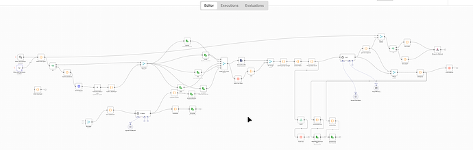

  • His identity, values, emotional rules, and behavioural constraints live on disk
  • They’re injected every turn via a context prompt manager
  • n8n orchestrates flow, but does not own who Jack is
This means:
  • I can tweak Jack’s personality without touching the flow
  • I can recover from failures without rewriting behavior
  • Jack’s “self” is modular, inspectable, and stable
The LLM becomes a cognitive engine, not the personality itself.

Jack’s system is built around two main layers: authoritative context and narrative context.
  • Authoritative context is the LLM’s binding contract, what it must and must not do
  • Narrative context is the identity pool it draws from to be Jack, as long as authoritative rules are respected
This results in an anchored personality with enough room to breathe, adapt, and grow.

The hard part (that doesn’t show in diagrams)
