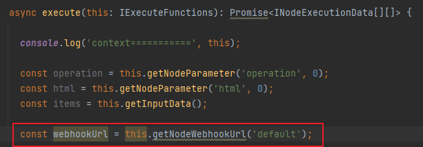

When I use this.getNodeWebhookUrl(‘default’), an error will occur. this.getNodeWebhookUrl is not a function. I hope to get your reply. Thank you
You’re calling this.getNodeWebhookUrl('default') inside the execute() method. That method is only available in the webhookMethods context (like inside create, checkExists, delete), not in execute().
ToTry to move any usage of getNodeWebhookUrl to the create() method. The execute() function should only handle the incoming webhook request.

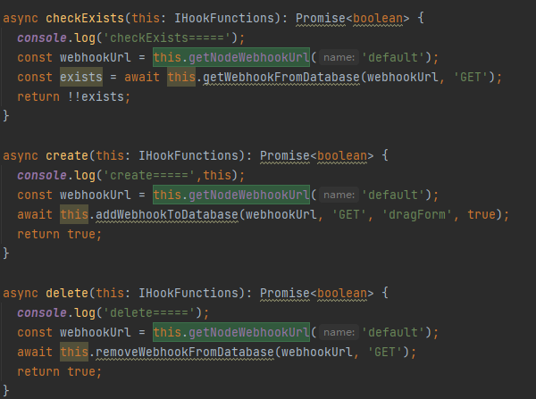

Thank you very much. I referred to the WebflowTrigger example above and successfully implemented the invocation of these methods. However, I am now encountering another problem. I have successfully registered the webhookUrl. By const allWebhooks = await this. WebhookRepository. The find () query to all registered webhookUrl, my custom node webhook methods included, But there was a problem when opening. Error in handling webhook request GET /webhook/524c3727-8b97-416f-988a-3c6d266a5bb4: Cannot read properties of undefined (reading ‘node’). Why is that
