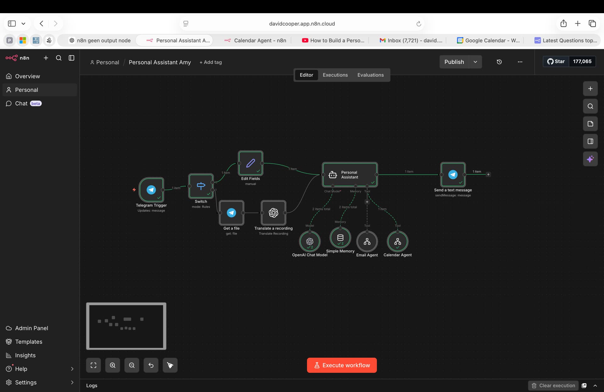

I am making a PA as a first project and as I’ve built it I came across a slight problem. Everything works inside the flow + calling a tool (another agent) for adding new events in my calendar / looking at the calendar. So now my calendar agent gives me a response (as a tool towards the ai agent in the PA) but that response is not taken in consideration, don’t know if it’s even received at all. please see attached pictures
Does anyone know the reason why? It seems to link to the correct agent, inside the agent everything works perfectly, the agent gives back the correct information, but the final AI agent seems to only get the response it gets from OpenAI at first, and doesn’t look at the information gathered from the calendar agent…

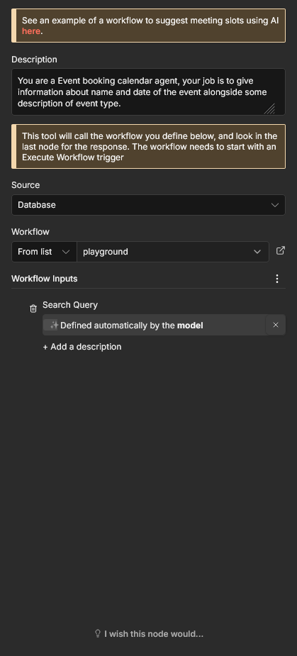

While there are better ways for doing that, for now consider giving description to the Main AI agent for the sub workflow tool and your sub workflow tool should look like this:
And with this make sure that your sub workflow is published and ready to receive the parameter you are sending, and also i would prefer just use the google calendar as a agent tool if that is considerable:

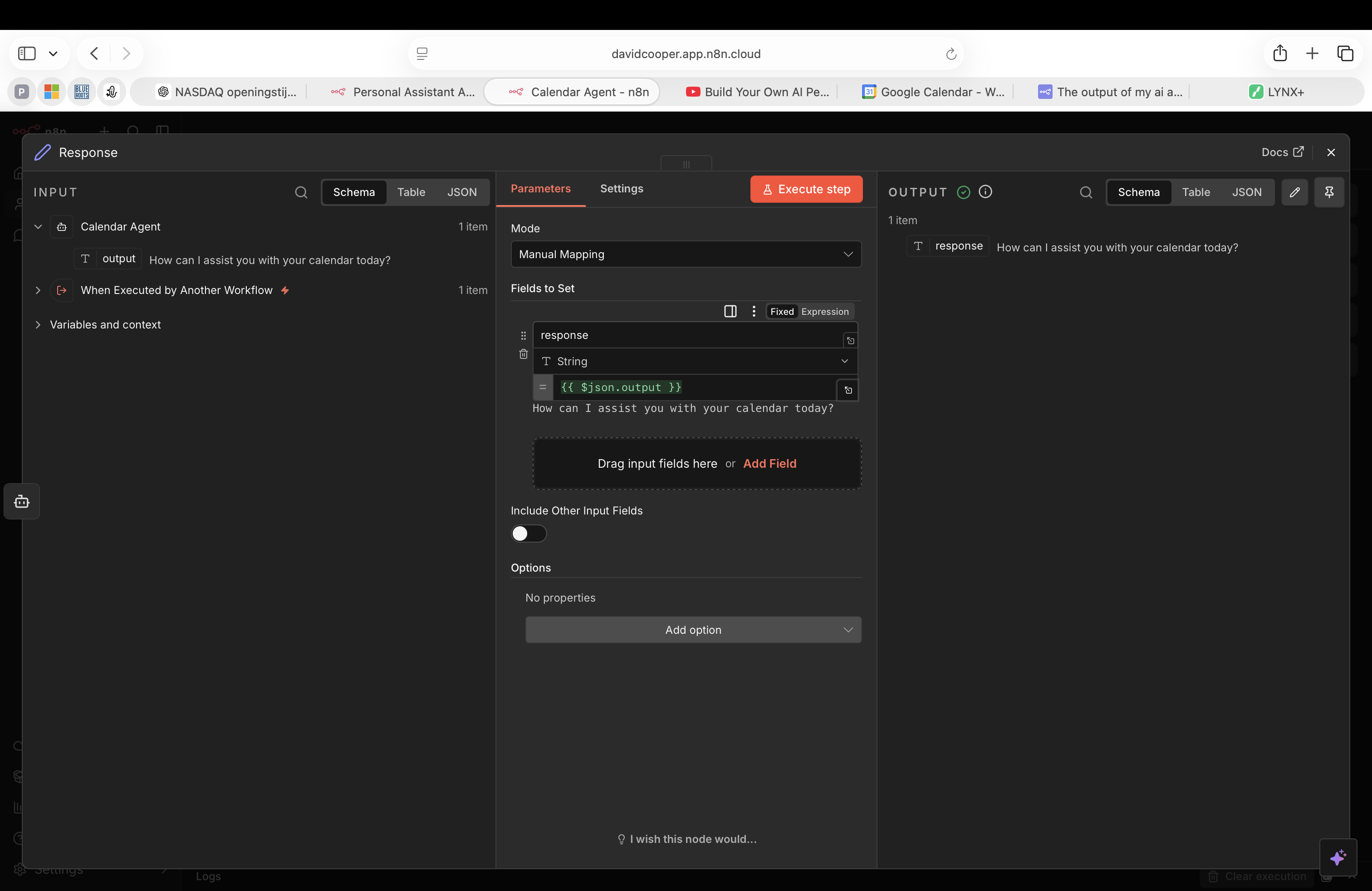

your calendar sub-workflow is returning the right data (you can see it in the tool output panel) but the parent agent is ignoring it, which almost always means the sub-workflow’s final node needs to output a single field called response as a string. if it’s named anything else like output or text the agent tool won’t pass it back to the LLM properly, so double check what the last node in your Calendar Agent workflow is actually outputting.

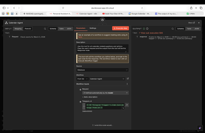

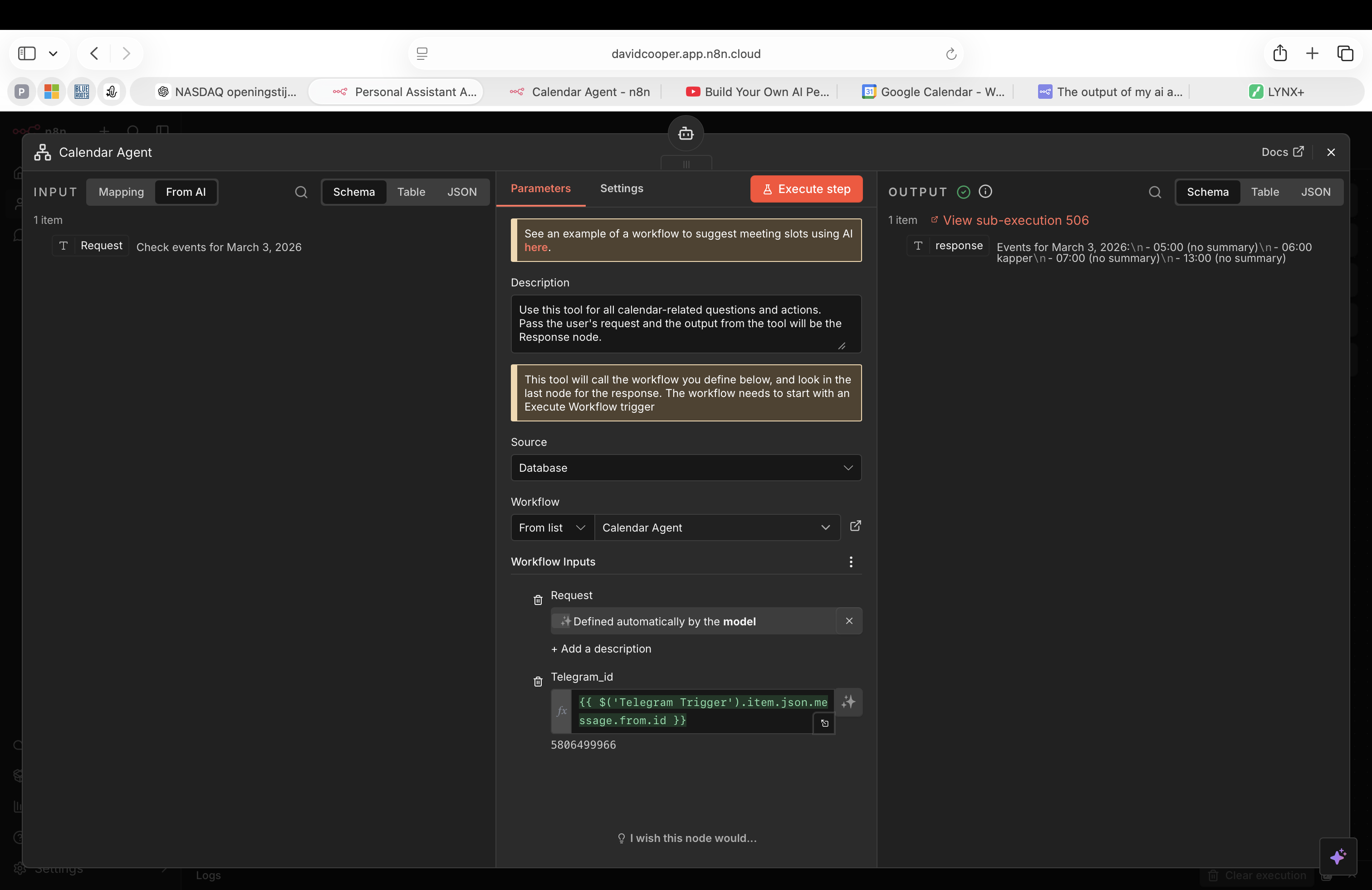

Thank you both for the reply @achamm @Anshul_Namdev . As you can see in this screenshot, I already have it as a call n8n workflow and the ‘output’ is already changed to response.
The response from the call n8n workflow also comes into the ‘main’ workflow, I also added a screenshot of the response when I ask: what’s in my agenda for tomorrow?. As you can see the agent replied, but then the ‘main & personal assistant’ agent didn’t receive it or just ignored it. I don’t really understand what you mean with the Agent v3 node since I didn’t add that in for as far as I know.. I’m totally new to this space, do I have that as my agent currently?

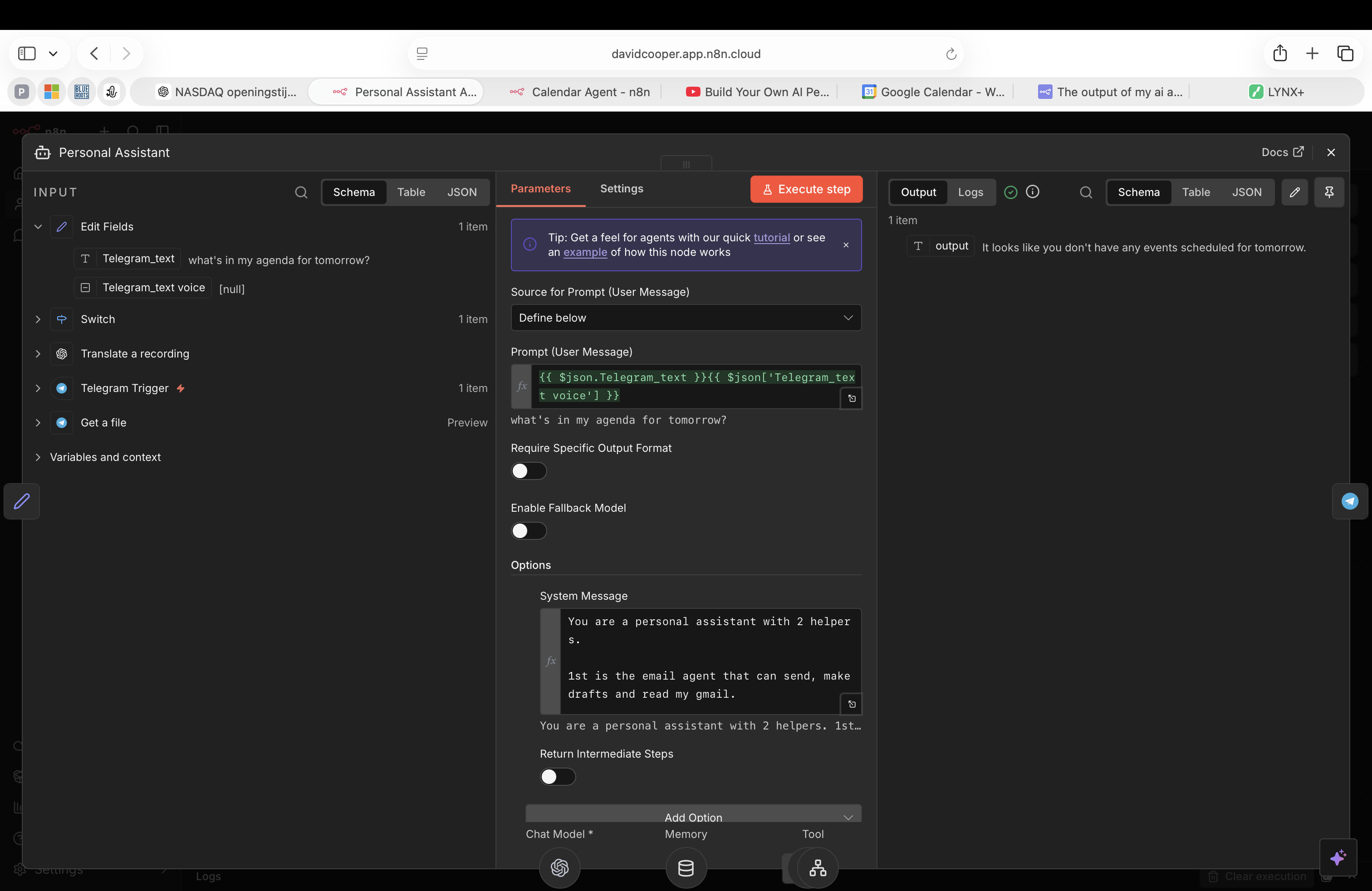

@Anshul_Namdev Thanks for the quick response. I just tried to run it with the following prompt:
You are a coordinating Personal Assistant that can use external tools (Email Agent and Calendar Agent).
IMPORTANT:
Whenever you call a tool, the tool’s response is the source of truth and MUST be incorporated into your final answer.
WORKFLOW RULES
  1. Decide whether a tool is required.
    • For calendar-related requests (checking events, creating events, updating or deleting events), you MUST use the Calendar Agent.
    • For email-related requests, use the Email Agent.
  2. After calling a tool:
    • WAIT for the tool response.
    • Read the FULL tool output carefully.
    • Treat the tool output as authoritative data.
    • Do NOT generate a final answer before receiving the tool output.
  3. Response handling:
    • Your final answer MUST be derived from the tool output.
    • Never guess or fabricate calendar or email data.
    • If the tool output is empty or unclear, explicitly state that no data was returned and ask a clarification question.
TOOL OUTPUT HANDLING
  • Treat any returned JSON or text as the “Tool Result”.
  • Extract relevant fields such as date, time, title, location, participants, and status.
  • Convert the Tool Result into clear natural language for the user.
  • Preserve dates, times, and important metadata exactly as returned.
OUTPUT RULES
  • Your response MUST clearly reflect the tool output.
  • If events exist → list or summarize them.
  • If no events exist → state that the calendar is empty and ask whether to create one.
  • Do NOT ignore tool responses under any circumstances.
Context:
Today’s date is {{ $now }}.
The user communicates via Telegram.
Any recommendations or other ways to build this PA? I just followed every step from this video: https://www.youtube.com/watch?v=iv0D-dHfK6w&t=533s
But now it seems that the output from n8n workflows does not come back to the main agent.. I use get-4o in the ai model.

@Anshul_Namdev it seems like my personal assistant does not wait / use for the response, as you can see in the attached screenshot, the personal assistant ai does now receive the ‘response’ and the information inside that node, it just decides to not do anything with it? Any idea’s?
