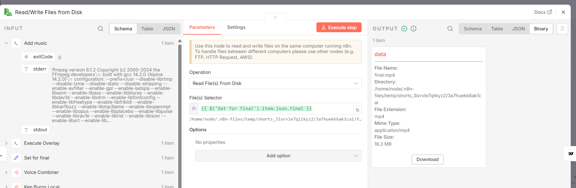

The read file node acts in a strange way. Can't resolve it
In using the read file node the node returns a valid file but I cannot download it using the button + the next nodes get a 9 byte empty file instead of the actual file.
Now I checked via FTP and I know for a fact that the file is indeed in place in the correct folder and have manually downloaded it to make sure that it is indeed a good video file with no issues.
Just to be clear it worked just fine a few hours ago I didn’t change any config files/compose data nothing. The node just stopped working.
This is how the file is read

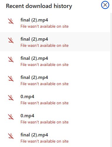

When trying to click download chrome says:

Hi @Alex_Satya,
I have the same issue and reported it about a month ago but still haven’t got a reply from the team,
However it seems to be a bug since the issue has been assigned to a team..
There are some workarounds mentioned on GitHub..
In short for now, you need to manually set the MIME type from application/mp4 to video/mp4
Hope this helps..
On the one hand good to hear that it is assigned. On the other hand the solution did not work for me :frowning: the file still doesn’t open.
Thank you for updating
For the time being as strange as it sounds I ended up using execute node with curl to upload a file…
