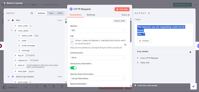

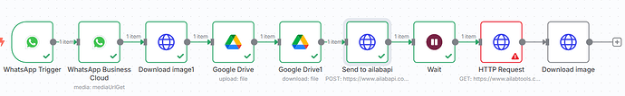

Hello n8n community, does anyone know how to fix this problem?, so i was trying to use the API ofr apilabtools. it works when the process of “POST” node but during “GET” node, it seems like it doesnt work or getting error.

From the documentation, it’s clear that it only accepts the POST method and not GET Hairstyle Changer Pro API | AILabTools
That’s why there’s a ‘not found’ error Response Description | AILabTools
so by that means i am not able to collect the photo?
Hi,
Before starting to build anything, you should carefully read the docs.
it’s all there in the docs:
the post will return the task_id and you fetch the result with another generic call.
reg.
j
