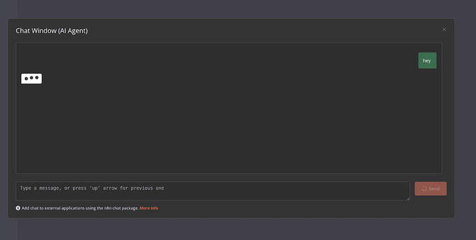

When I try to create a basic flow with a conversational agent, I do receive the output, but only when I stop the workflow. I can’t get direct responses in the chat section; when I send a question, the response never displays, as you can see in the screenshot. Does anyone know why?

Hello,
Here is a screenshot of my workflow.
I’ve noticed that regardless of the flow I use, I can never get the outputs directly. I see “executing workflow” loading, and nothing happens. If I want to see the results of my workflows, I always have to go into the executions.
And this happens with any type of workflow, with or without AI
