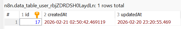

In n8n Data Tables, the row system timestamps appear inconsistent:
  • When a row is first created, createdAt (and updatedAt) reflects my configured instance’s timezone correctly.
  • After updating the same row, updatedAt is stored and returned in UTC, causing createdAt and updatedAt to be shown in different timezones.
I’ve posted more information about this problem here as well: The updatedAt column in Data Tables uses wrong time zone · Issue #26070 · n8n-io/n8n

For reference, here’s the complete information about this problem in my case:
Bug Description

  4. Observe the row createdAt and initial updatedAt values (they match, and use correct time zone).
  5. Update the same row (e.g. edit a cell) in a flow.
  6. Observe that updatedAt is now in UTC, while createdAt remains in the original timezone/format.
Actual Behavior
createdAt appears in my local/instance timezone, but updatedAt appears in UTC after updates.
This row was created while my system shows the same date/time as “createdAt”. When the row was edited, the “updatedAt” is expected to also reflect the current displayed date/time, however the value of the UTC date/time was used to update it instead.

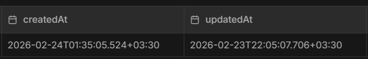

Yeah this is definitely a bug, not a config issue on your end. The createdAt vs updatedAt timezone mismatch you’re seeing in that screenshot (one showing your local time, the other UTC) lines up with what’s been reported before — looks like the create path respects GENERIC_TIMEZONE but the update path hits the database directly and gets UTC instead. Setting TZ in your environment might help as a bandaid but honestly the real fix needs to happen in the node code itself. I saw you already opened the GitHub issue and have a PR draft going which is great, hopefully the team picks it up during triage soon.
@A_A4 Thank you for the suggestion!
Sadly, it appears that having TZ set has no effect, the problem still persists:
(It may be that the TZ isn’t being picked up from the .env file, but since the other keys seem to have been picked up, this seems unlikely.)
