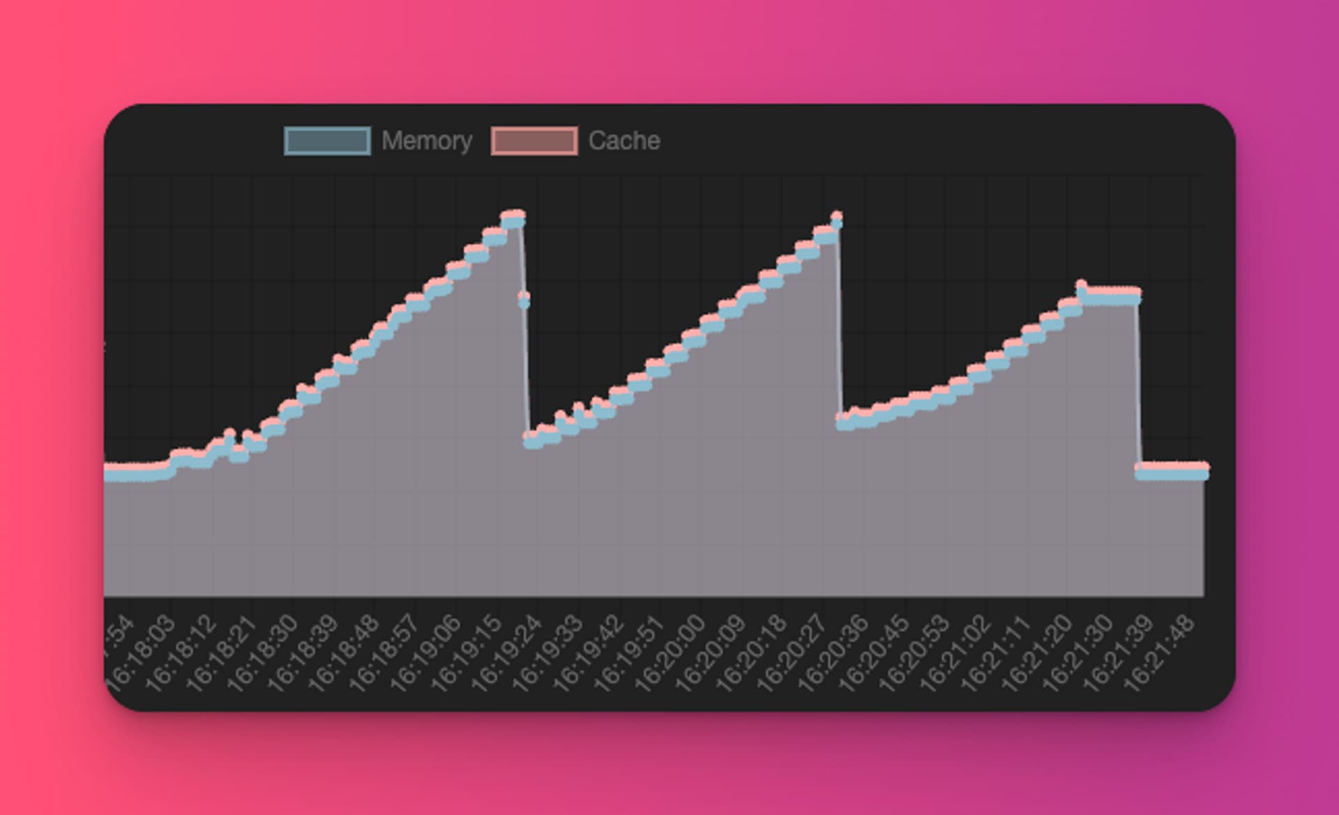

I have just done a bit of testing on this one, I have a parent workflow that generates some items then for each item executes a workflow that generates 10000 items and ends with a set node that runs once to return a bool.
So for the first test I did 10 items that generate 10000 each in a sub workflow and my memory usage looks like this…
The thing to note there is once the memory gets close to 700MB it has dropped down a bit then climbs again and once the entire workflow ends it drops down fully to the baseline.
So next up I did 50 items that generate 10000 each and I ended up with this…
So we have a better picture of what is happening the memory is growing to a certain point then it is clearing as it needs to, There is a slow grow in the baseline when it drops each time so test that more I have done one more test…
This one is 100 items generating the 10000 items in each sub workflow call…
It is a similar pattern with memory usage growing and dropping as it needs to, At the moment based on these it does look like everything is clearing up as it needs to.
