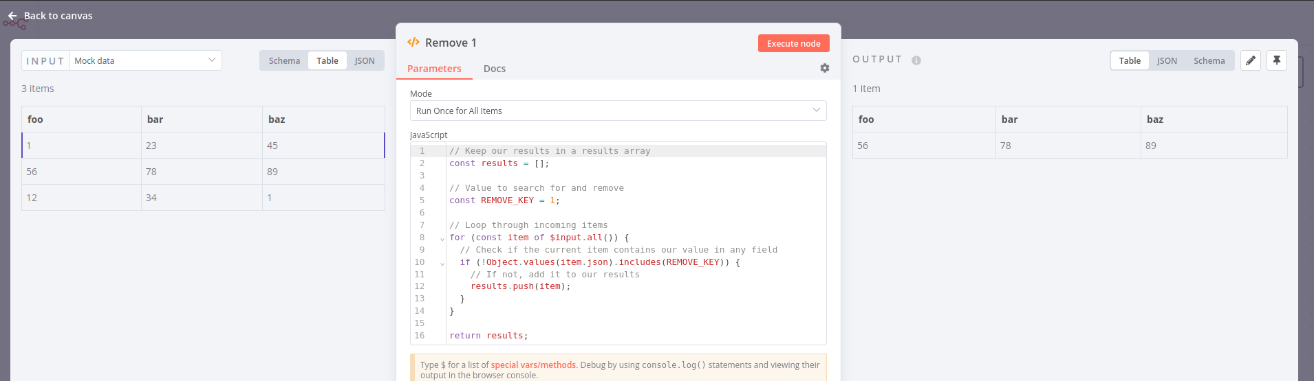

Are you looking to delete all items with a value of 1 in any field? So in a dataset like below, you’d like to delete the top and bottom item, but keep the middle one?
I don’t think there’s a simple way to achieve this without Code. With a bit of JS it should, however, be relatively simple. Here’s an example:
Result:
Hope this helps!

I want to target the entire json and replace all 1 numbers. There’s a way to do it?
Hey @Igor_do_palido_ponto,
Did the example not help? It looks like it close to what to what you are after although I don’t know what you want to replace the number with but it should work as a starting point.
