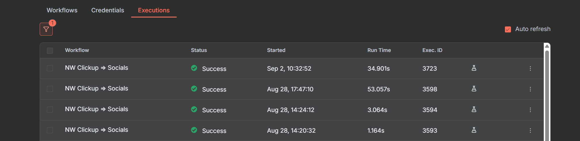

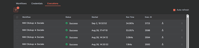

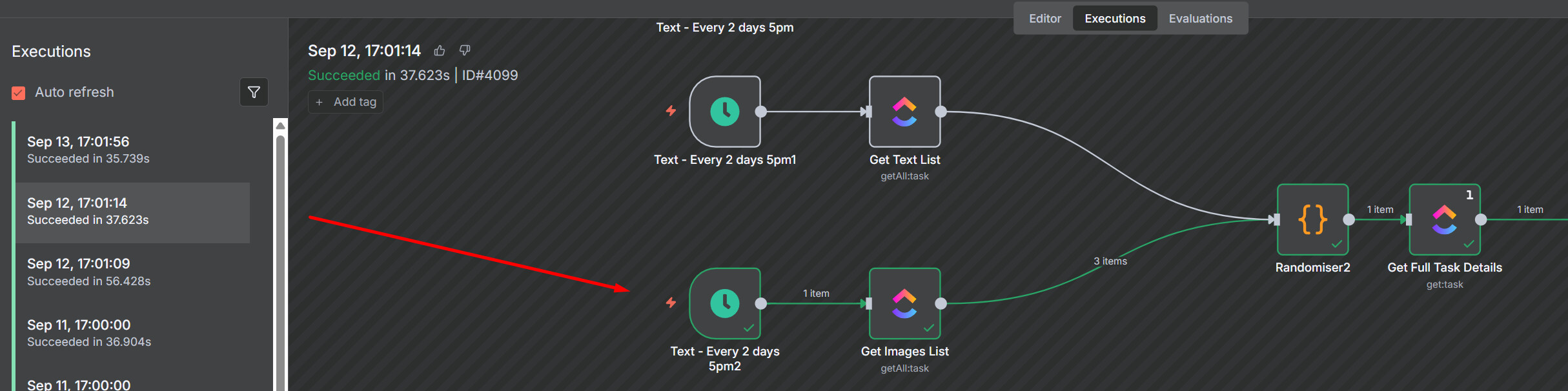

Can you share the execution when you activate the workflow from executions tab? Maybe we can look for something from there
Sure - how can i do that ? execution list screenshot?
Thank you for your support @cutecatcode
Find out the executions without Labs icon (Aside Exec.ID), then screenshot the workflow by clicking the workflow name
Unfortunately there are non without the lab icon - this workflow seems never activated by its own..

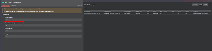

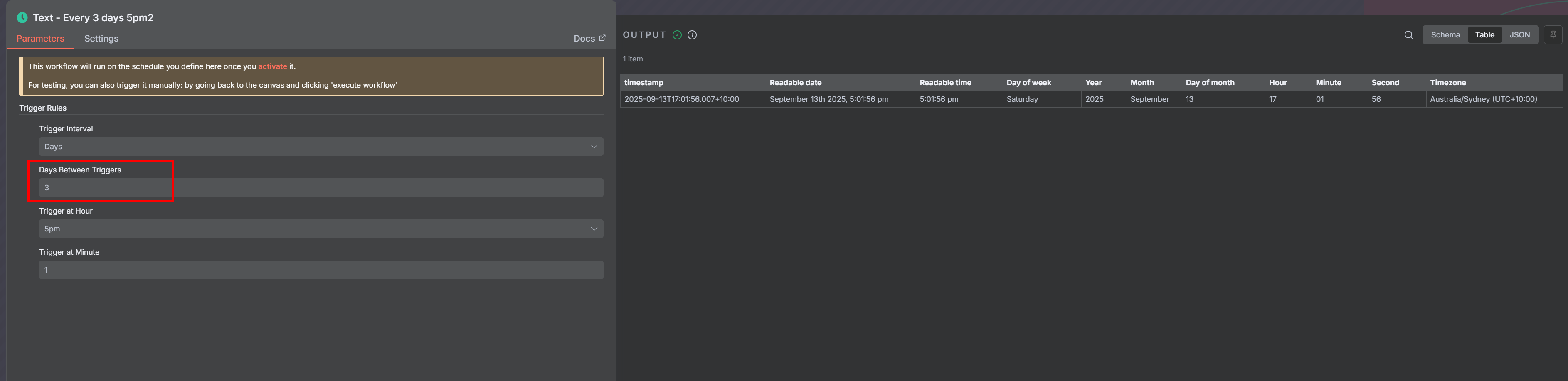

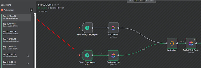

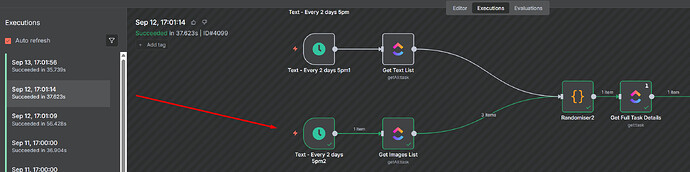

Unfortunately, the workflow is still not functioning as intended.
The time zone appears to be set correctly in the time trigger.
However, it is supposed to trigger every three days, yet it is currently triggering every day. I am not sure why it is behaving this way.
Any ideas?
