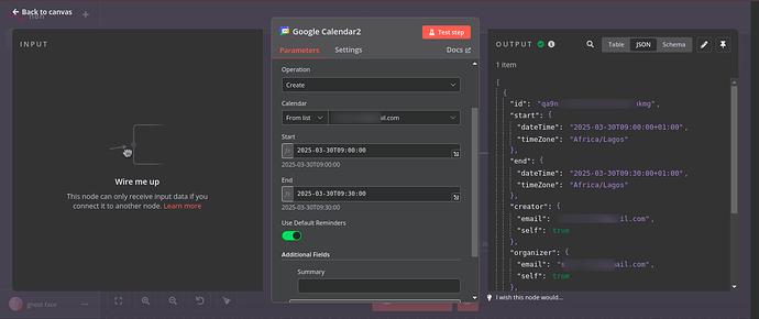

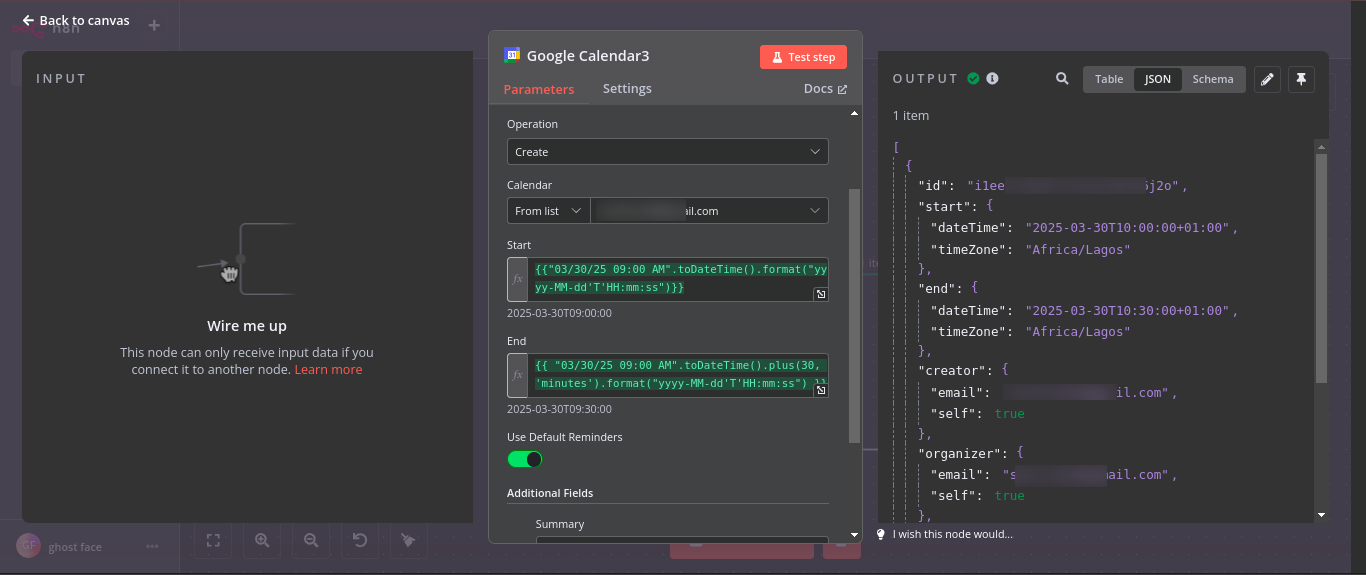

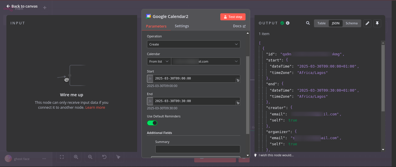

Hey @Ibrahim_Sajid_Malick, I find your answer to be correct & accurate. How can I implement this in my workflow.
Context:
When I used the dateTime string without the timezone offset, the event is created correctly on google calendar. However, when I try performing date transformations to get the exact date string to create the event, the event is offset by 1hr as shown in the output. How can I fix this?
Attached are some screen shots for clarity.
