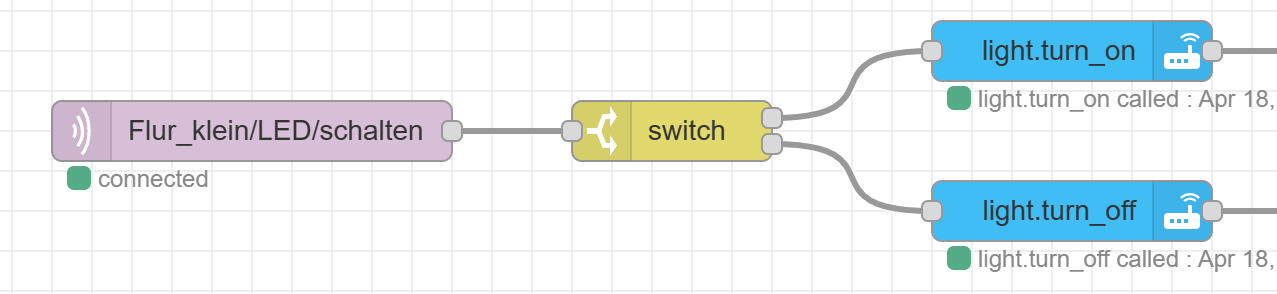

I’ve created a really simple flow.
When on the MQTT Topic a Payload with “on” is received I want to turn on my lamp.
n8n needs from sending the MQTT Payload to turn on between 2 and 4 seconds. Even when the log says something else:
My n8n is running on unraid/Docker.
I’ve got set up the very same flow in Node-Red, also in unraid/Docker (same Machine) and the light turns on immediately (<0.5s).
Why is this? Is it possible to change some settings, I didn’t find anything…
