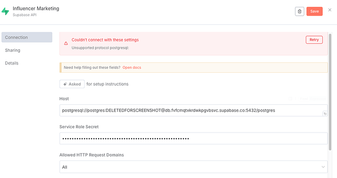

I am having issues connecting Supabase to n8n. I did it once before, so I must have had the ability to pull it off, but Supabase had an update to the API this week, and I wonder if that is the reason.
“Couldn’t connect with these settings
Unsupported protocol postgresql:”
  • n8n version: Version 1.110.1 Cloud
For the Supabase Host Name I put in a string with this structure: postgresql://postgres:[email protected]:5432/postgres
For the Service Role Secret I used the one from the legacy api keys window in Supabase.
Any way to fix this with the current Supabase node?

Your Host value should match the template https://<project_ref>.supabase.co
Check the docs: REST API | Supabase Docs

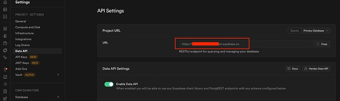

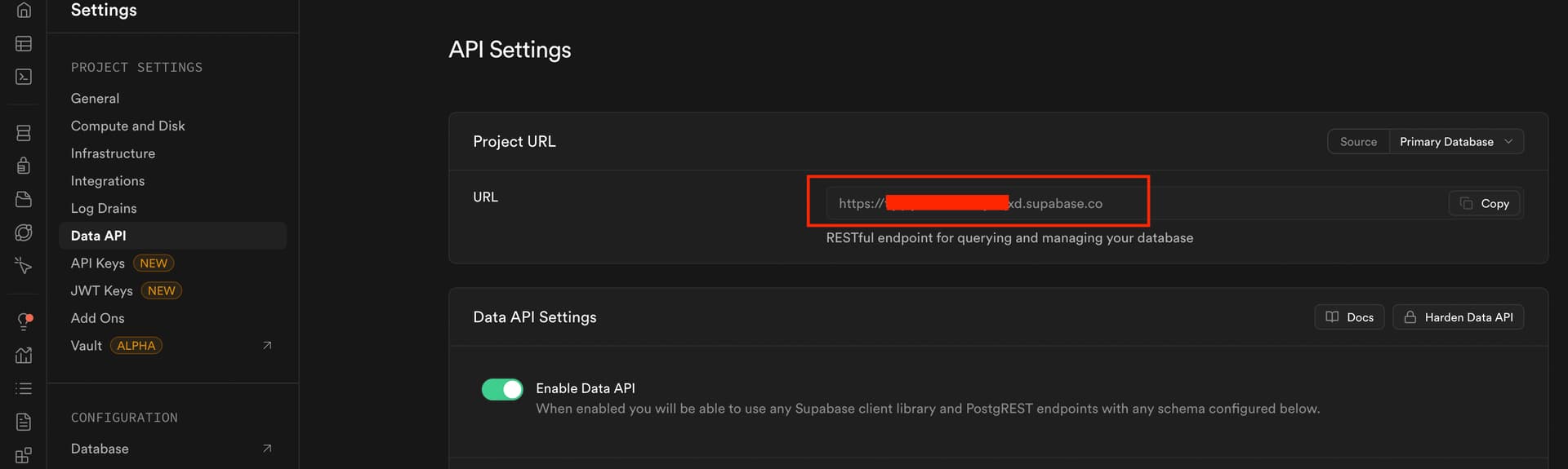

If you’re suing the Supabase node, then you need to find the api url and NOT the database connection string. In supabase go to “Project Settings → Data API”
It’ll look something like this:
Much appreciated. Solved :slight_smile:
