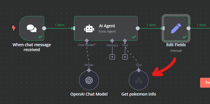

Hey @Prince_Mathew , I think I found the solution you need:
I think there’s no way to do that directly, unfortunately.
There’s a workaround, though:

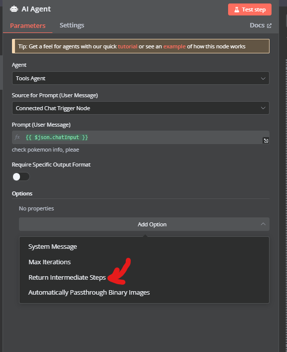

Add this option to your Agent
Enable it

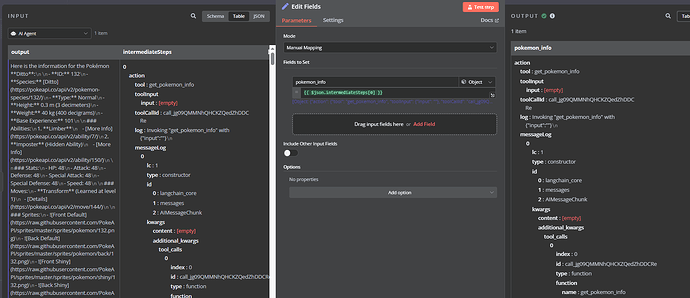

When this tool runs…

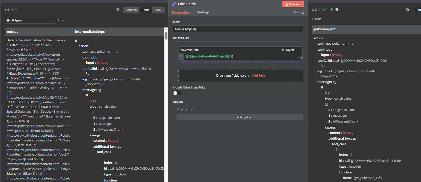

You will see its result in the output:
if you want to filter by the tool name, you can do it like this:
{{ $json.intermediateSteps
    .filter(item => item.action.tool === "get_pokemon_info")
    .map(item => JSON.parse(item.observation)) }}
