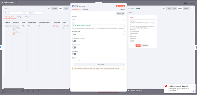

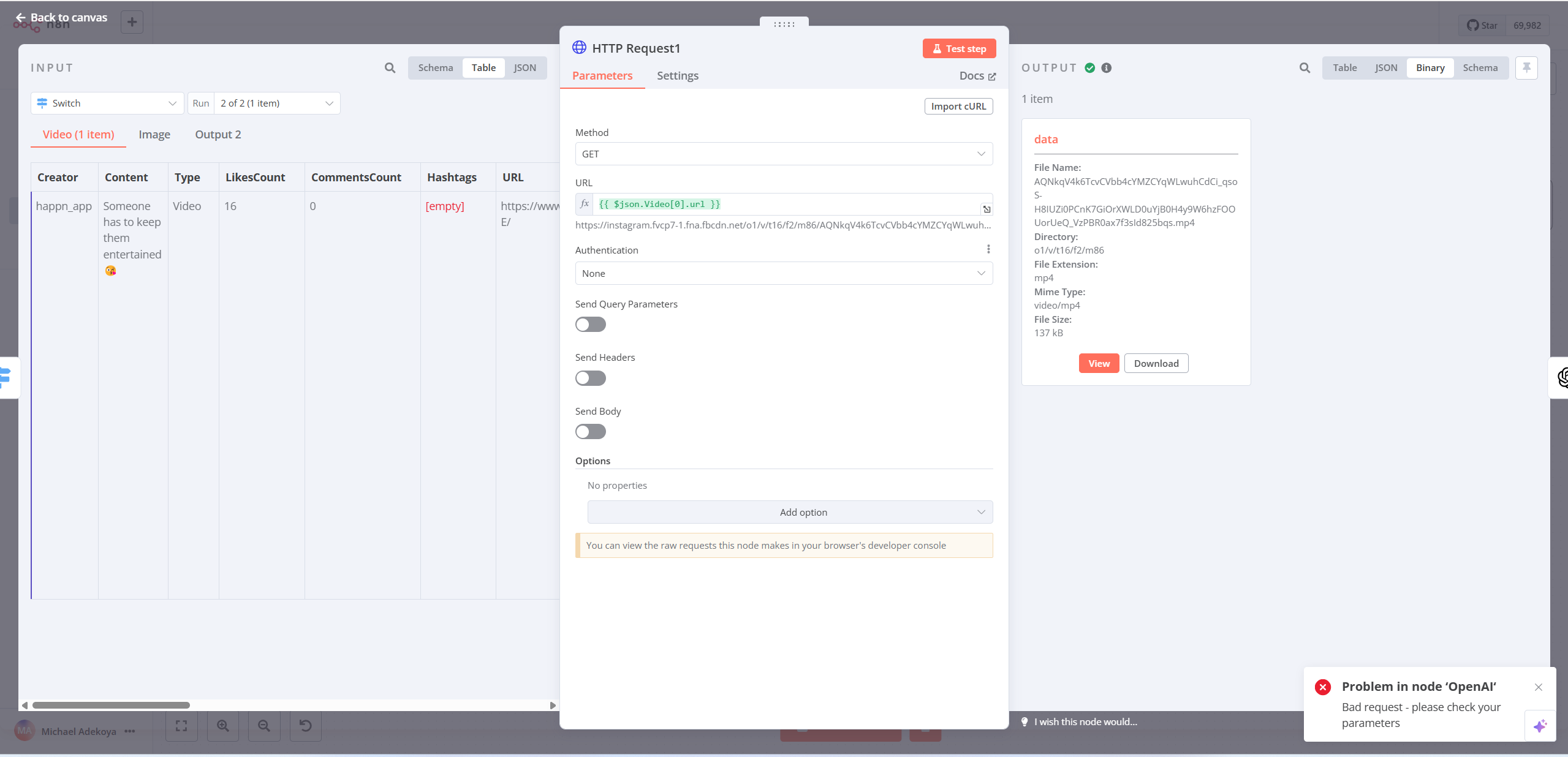

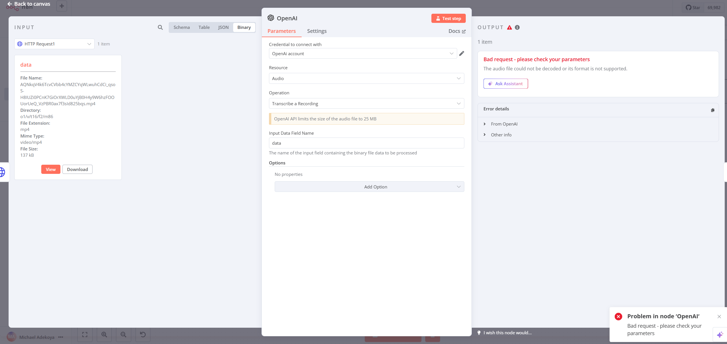

Hi, I am trying to transcribe a video using the OpenAI transcribe node. The video is coming from an HTTP request. In the transcribe node, I get an error that says audio cannot be decoded. I have attached the images. Looking forward to your help. Thanks
Hey @Michael_Adekoya You can’t use this node with video. You would have to extract the audio first to be able to transcribe it

You could use a paid API MP4 to MP3 API | A High-Performance MP4 to MP3 Converter API
If you have your own server running FFmpeg, this could be an option as well (would be possible if you would self-host) but could be deployed as standalone.
Also check out this thread Optimizing Content Automation: Best Way to Extract and Process Transcriptions in N8N? - #3 by Giulia_Patricio where I suggested some options with Gemini but if you have a big video I don’t have a good plugin solution worked out yet.
