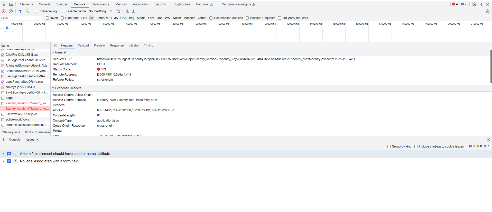

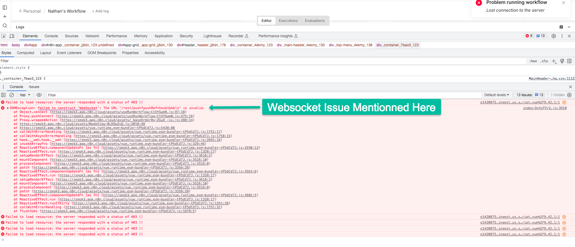

  7. Quick Test : here is a Console Screen Capture
    In network I get several 403s (3 to be exact) See screen capture as well
I can video capture too should it be helpful.
Thanks in advance

What Those 403s Tell Us
The fact that you’re seeing exactly 3× 403 errors suggests:
  • These are likely WebSocket upgrade attempts being rejected
  • Or authentication tokens being blocked by a content filter
  • The pattern (exactly 3) suggests retry logic
Can you share:
  1. The exact URLs of those 403 requests from Network tab?
  2. Any error messages in the Console tab related to WebSocket or “ws://” or “wss://”?
This will help us pinpoint exactly which connection is being blocked.
Immediate Workaround
While we debug this, use:
  1. The other Mac (where it works)
  2. n8n Desktop App on this Mac - it might bypass the block
  3. Your phone’s hotspot to isolate if it’s WiFi-specific
We’re getting close to the root cause! The 403s are actually good news - they give us a specific error to track down. Let me know the results of the Safe Mode test and those WebSocket error details.
Before running all the new suggestions, a quick note.
In the screen captures I attached, one mentions “DOME Exception: Failed to construct ‘WebSocket’: The URL ‘/rest/push?pushRef=dacbztu0ft’ is invalid.”
I am reattaching the screen capture and pointing to the referred event in case it allows for a rapid solution.
The 3 urls for the 403s are in reality the same url 3 times.
https://o1420875.ingest.us.sentry.io/api/4503960699273216/envelope/?sentry_version=7&sentry_key=3a848d77e104fa41f2735a1d3a1ef8e7&sentry_client=sentry.javascript.vue%2F9.42.1

I had already exchanged some information about the situation I am facing and performed some tests recommended by @hoiyothaheem the other person kindly assisting in this thread. Yoy may find information of interest regarding my particular situation.
Regarding your questions:
  • I will paste the workflows here below. They are the 2 workflows used as teaching material in n8n level one course.
  • No execution was ever completed on my computer. I have run the longer one once on the computer of a colleague, sitting right across my table.
  • The connection lost message appears even before executing any workflow.
