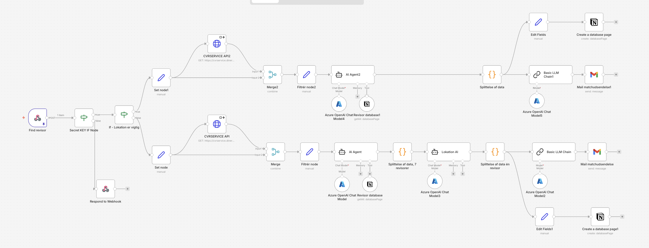

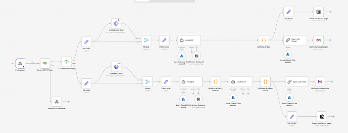

This is my workflow.
So I have a webhook coming from a standard formular on our page.
In the end of our workflow it creates and sent an email.
That email keeps on being sent, again and again. like it keeps being executed, ones every day at the same time.

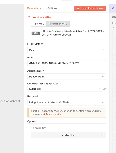

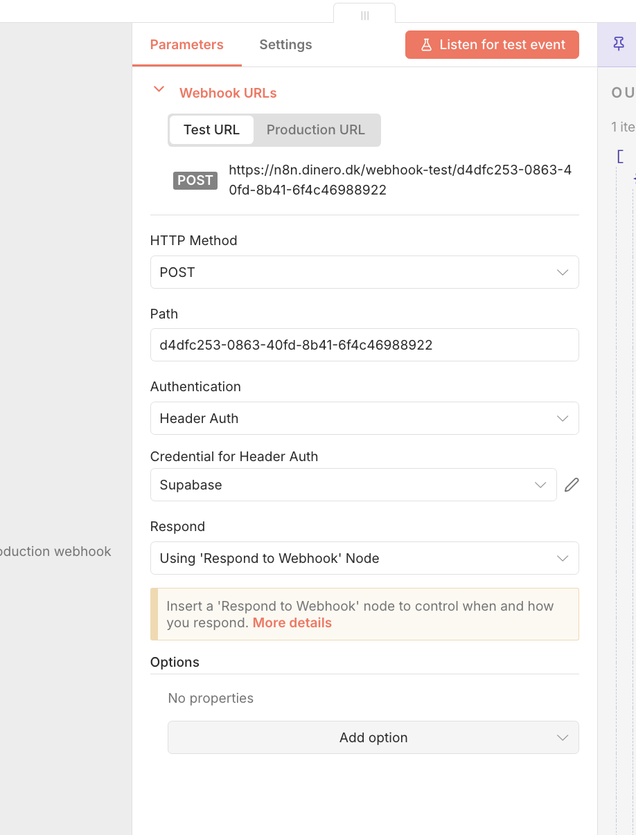

This is my first webhook:

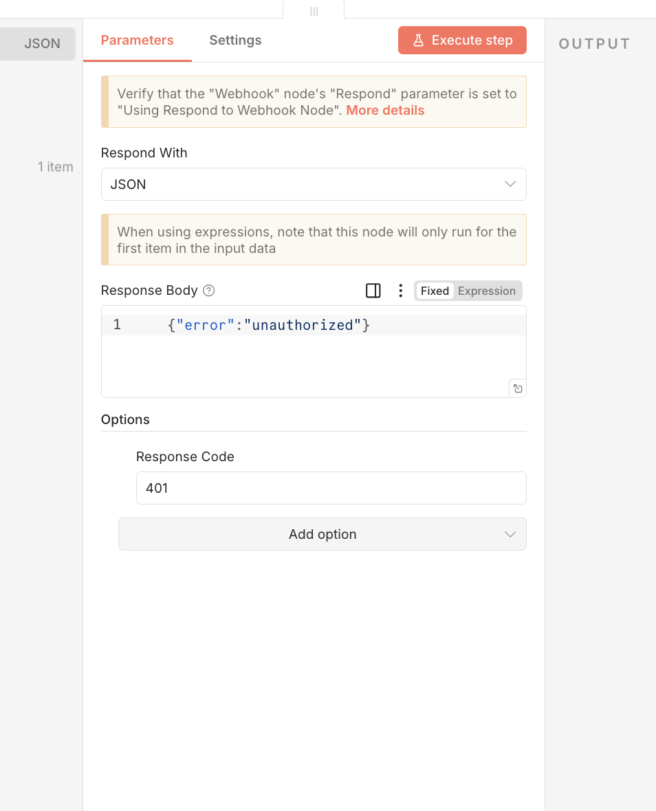

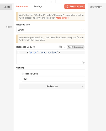

If true it goes to finish execution and if fails it goes to this:

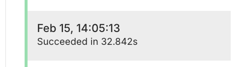

When the execution is done it looks like this in the last node:
So this execution we didnt do ourself. It’s something that keeps being triggered every day somehow.

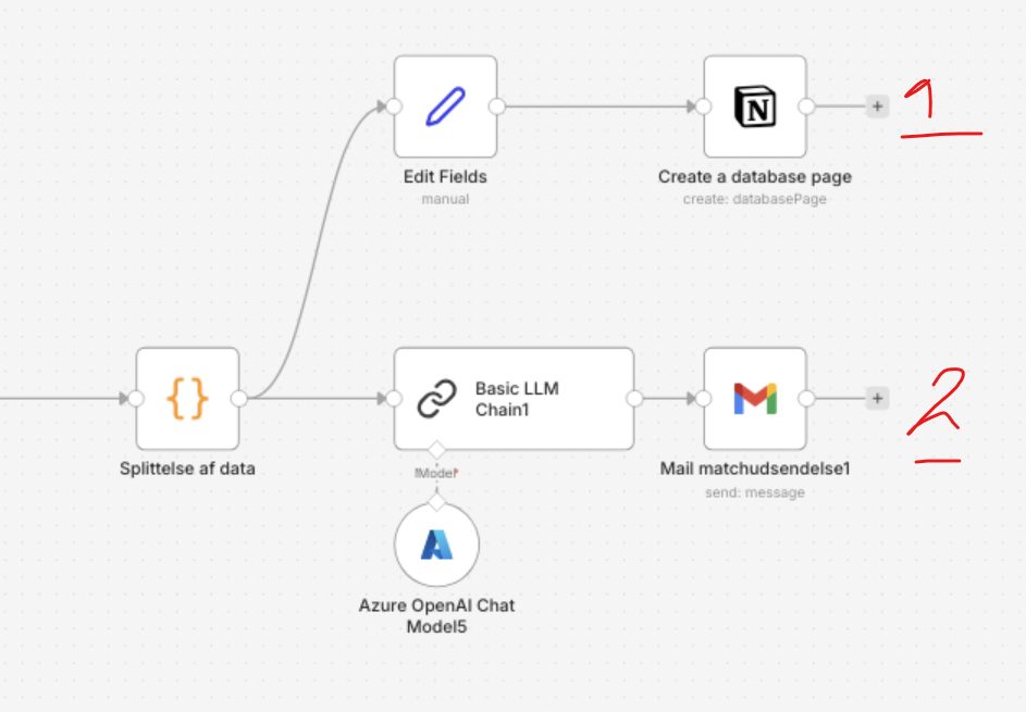

As far as I see, you have configured the webhook to send a response with the “Using Respond to Webhook Node” option; however, your workflow design doesn’t contain that node for the True branch of the Secret key IF node. Moreover, both branches might output two results sequentially, as you are splitting the execution into two in the ending section:
Use the Merge node on the ending part (numbers 1 and 2 on the screen), with the option Choose Branch >> A single empty item, to merge the branches, then add a response to the webhook node with something like code 200.
