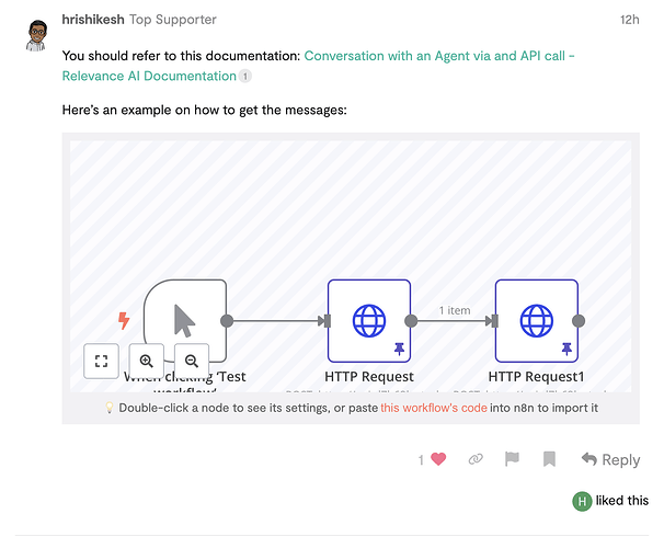

You should refer to this documentation: Conversation with an Agent via and API call - Relevance AI Documentation
Here’s an example on how to get the messages:
Thank you so much for the help! My workflow is looking great, thank you!
