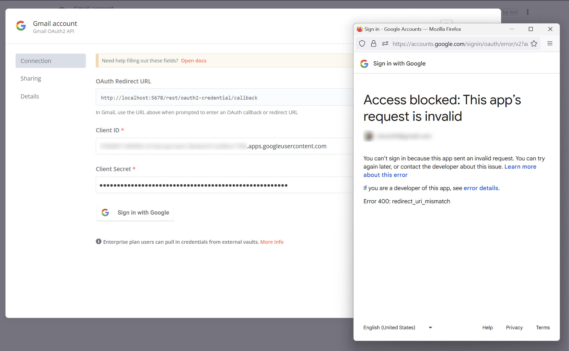

Hello! I’m having some issues configuring my credentials for my Gmail account (using the Gmail OAuth2 API). When I attempt to connect, I get the following error:

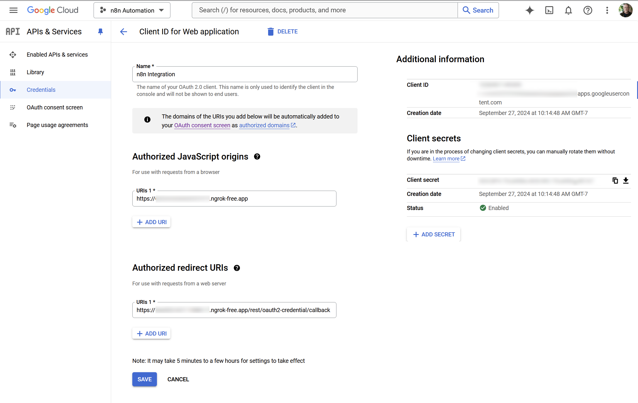

Here’s my configuration for my credentials in Google. Notice that the Redirect URL is https://xxxx-xxx-xxx-xxx-xx.ngrok-free.app/rest/oauth2-credential/callback (the actual URL has a valid ID instead of x’s)

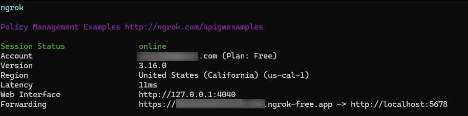

The forwarding URL in ngrok is https://xxxx-xxx-xxx-xxx-xx.ngrok-free.app (again, x’s replace the actual id, but it matches what’s in Google)
In my OAuth consent screen settings, I have my authorized domain listed as https://xxxx-xxx-xxx-xxx-xx.ngrok-free.app:
My scopes and test user is set up correctly as well.
I’ve tested the Sign in with Google button in Incognito mode as well. I’m using Firefox.

You can’t sign in because this app sent an invalid request. You can try again later, or contact the developer about this issue. Learn more about this error
If you are a developer of this app, see error details.
Error 400: redirect_uri_mismatch

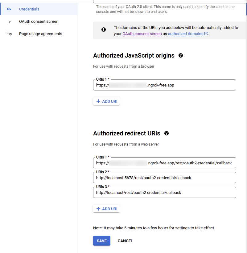

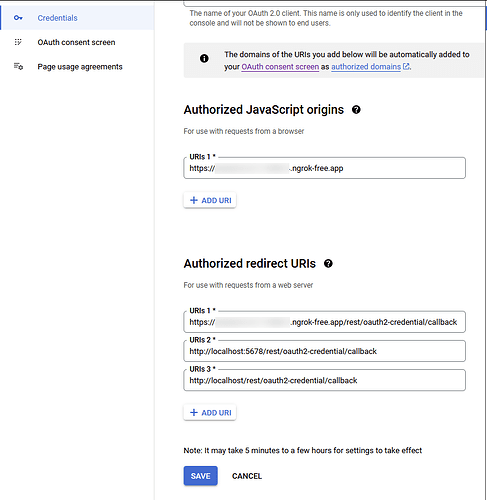

Ah, I got it to work!!! Unfortunately, I don’t know why it worked, but here’s what I did:
Along with the ngrok address, I also entered both of these URLs:
http://localhost:5678/rest/oauth2-credential/callback
http://localhost/rest/oauth2-credential/callback
And it magically worked. Thanks!
