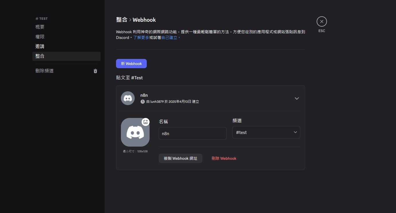

I’ve been exploring methods to capture Discord messages. Initially, I looked into using Discord’s built-in webhooks. However, after researching, it seems that webhooks are primarily designed for sending messages to Discord and might not be suitable for receiving messages triggered by user input. Is this understanding correct? I’ve searched extensively for solutions, but haven’t found a way to make this work.

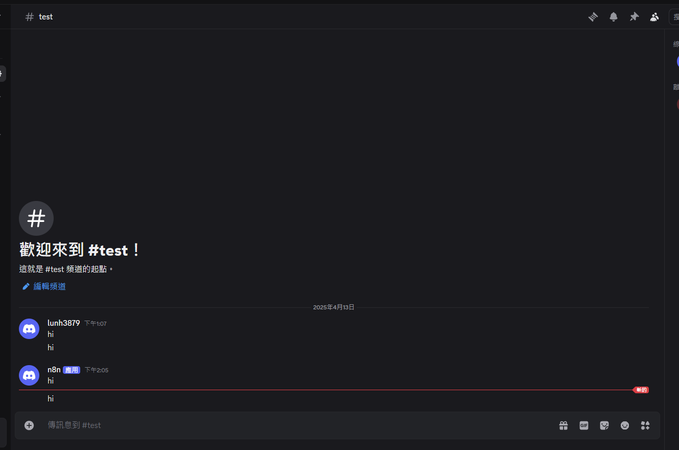

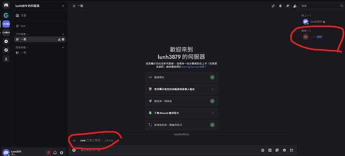

The problem I’m facing is that I can’t seem to get this trigger node to actually receive any messages from my Discord channel. I have created my own Discord server and a dedicated channel within it. I’ve also created a bot account.
Interestingly, I can successfully send messages from n8n to my Discord channel using other Discord nodes. The issue is solely with capturing the messages that users send in the channel.
