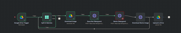

Thank you for the answer,
Here’s an example of exactly what I’m trying to do, maybe it explains better:
I download an image from my Google Drive as binary, and it comes out as data in the output. The next node describes this image and creates a text prompt.
The last node should take both this text prompt and the binary image output from the first node, and remix them — so it should use both the image and the prompt.
But in this last node, I can only get either the prompt or the image.
When I add both to the body, it always throws an error.

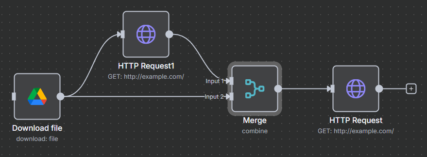

I think you just need to use the “Merge” node with “Combine” mode and “all possible combinations”
something like this
thank you very much, this method solved it all :smiley:
