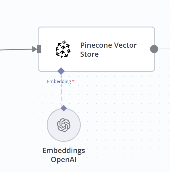

My workflow setup was essentially correct:
However, the Pinecone node requires that the “text” key exists in the metadata.
I updated my python script, upserted the data into the pinecone database, and there you have it! It worked!
