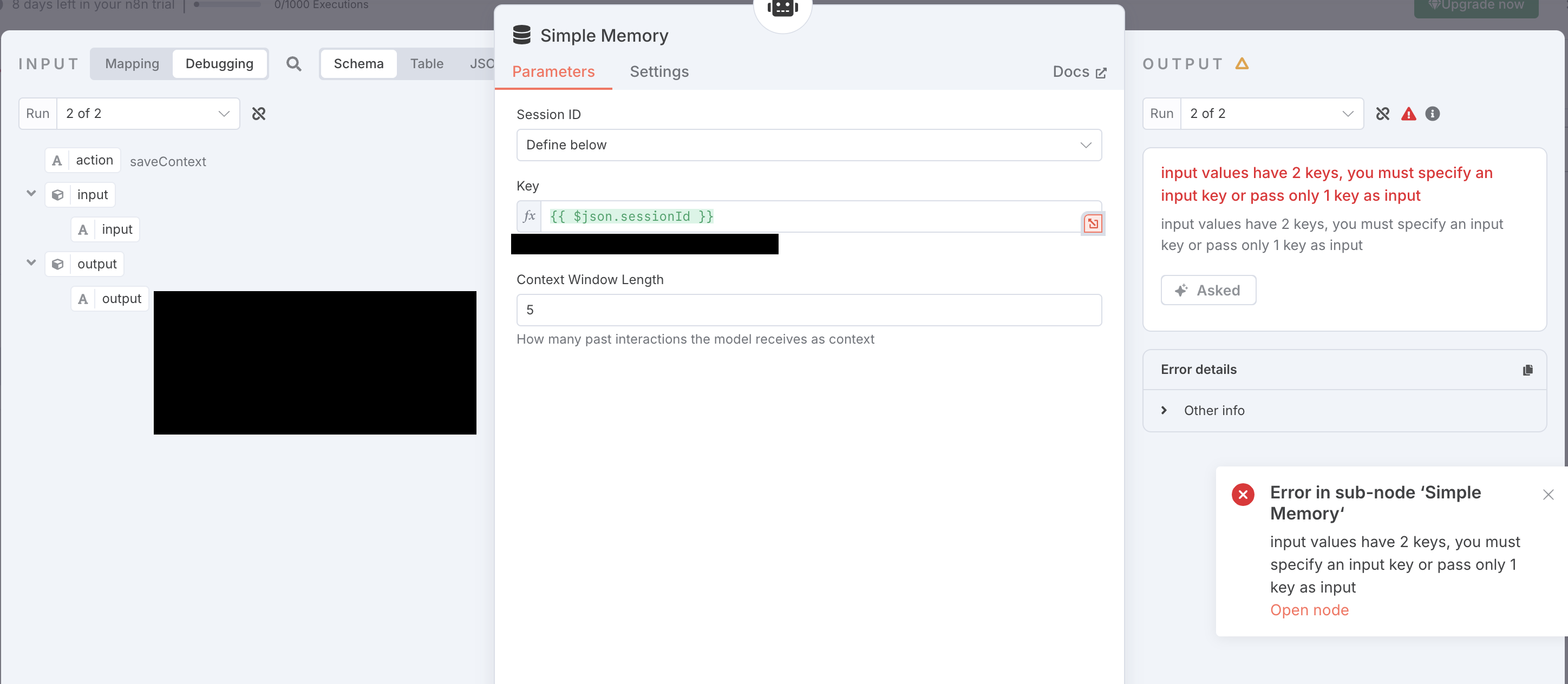

I’m having a problem with my Simple Memory; it started saying I have 2 keys, but I only see one. I wasn’t having this problem earlier, and everything was working great. I tried asking the AI Assistant, but it didn’t help. Does anyone know how to fix this?

Error message:
Error in sub-node ‘Simple Memory‘
Input values have 2 keys, you must specify an input key or pass only 1 key as input
Screenshots:
Starts with 1 item, then goes to 2 after a prompt?

So, it seems to be because of the node before running two times. Your current key should be correct if ran once. Could you share your workflow?
Thank you for responding. I looked at your deleted suggestion and it helped me connect the dots that I needed to put {{ $json.chatInput }} in the prompt space for my agent. It seems to be working fine now, Thank you.
