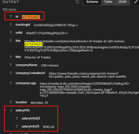

JSON format misses the value “SalaryInfo[1]“, whereas the schema includes it. How can I pass the “SalaryInfo[1]” value in JSON so that then I can use it in my next workflow step?

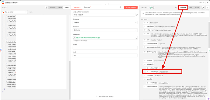

I’m able to reproduce this exact issue with Apify response,
The good news is that it appears to be a UI bug or misbehavior in the Schema view when the number of items is greater than one, in that case, the values do not match..

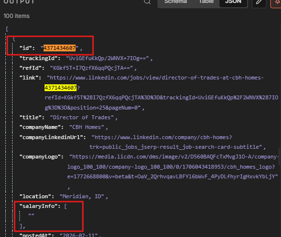

The good news also is that the JSON view is correct, and the referencing is correct..

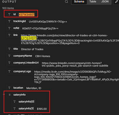

- Here, the schema shows that there is salary information:

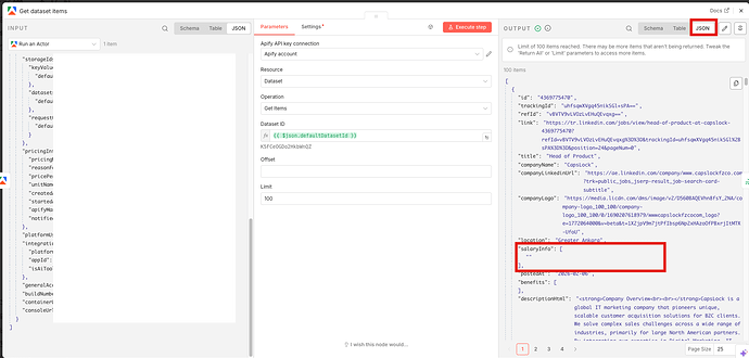

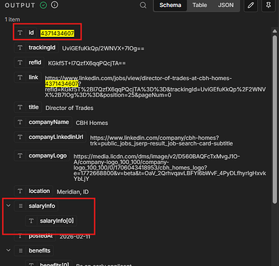

Now, if you go to the actual JSON object with the same ID, you’ll see that there is no such information:

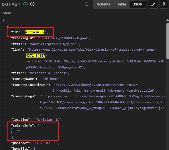

However, when extracting only this single item and looking at the Schema view and Json view, both are correct:
So in the end, everything works correctly when referencing, just don’t rely on the Schema view values,
I believe it is intended only to show the general schema structure..
