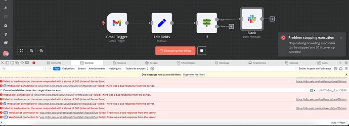

I recently installed n8n using Docker (portioner) with the following configuration. However, I’m facing an issue where my workflows keep running indefinitely with an error message in the Docker console: “This session (id) is not registered.” Additionally, the JavaScript console consistently shows the error “problem stopping execution.”

  1. Docker Console Error:
  2. JavaScript Console Error:
