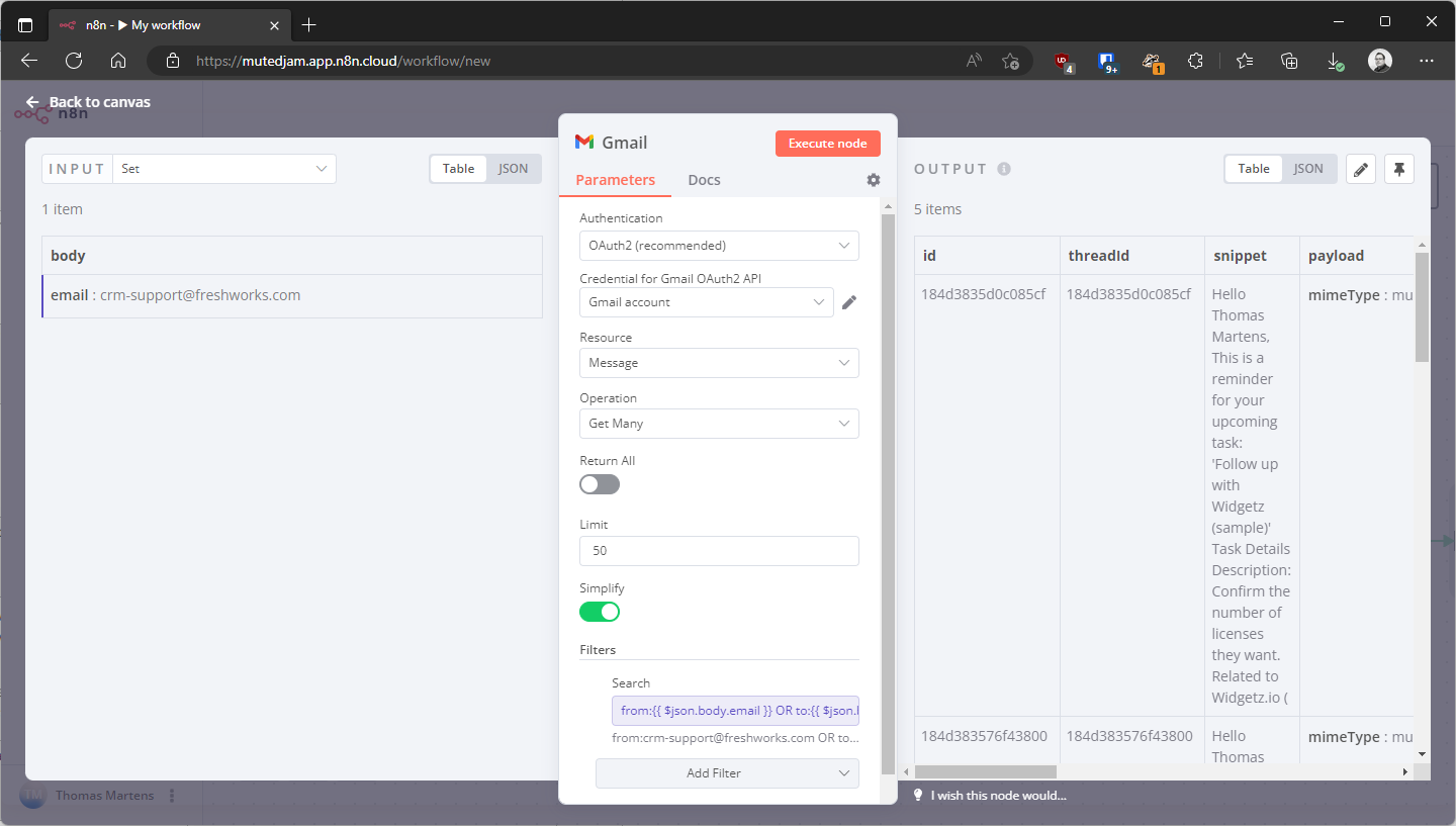

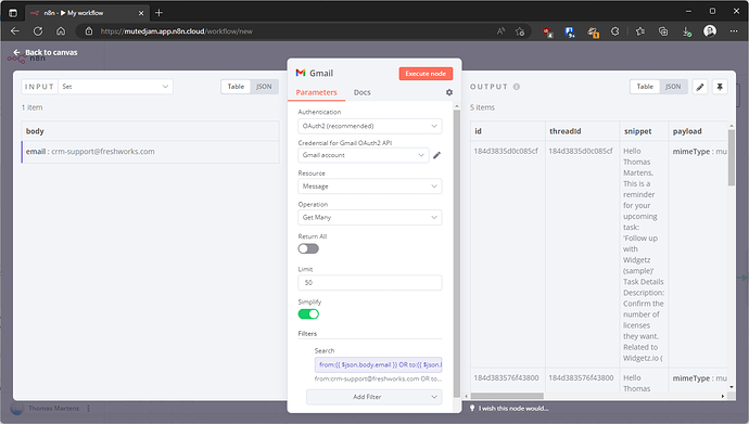

Hi @Liepiecie, I am not sure if has can be used to search for emails by address. But the basic idea of using expressions in the search field should work:
I’ve tested this with both n8n 0.204.0 and n8n 0.205.0, however, I was using the recommended OAuth method to authenticate instead of a Service Account. Perhaps you can give the OAuth authentication a go and make sure you’re on a recent version of n8n?
