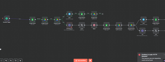

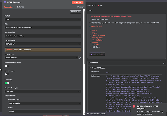

Twitter image post http not working
my twitter image dont load up what can i do
PLEASE help

thank you for trying to help but i did add the +media.write but still not working
i use that in my dev account

i dont get it what do i have to change in n8n can you show me how it should look like so i can copy it i dont know anything about codeing or api i dont understand the init appent finalize

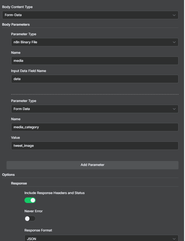

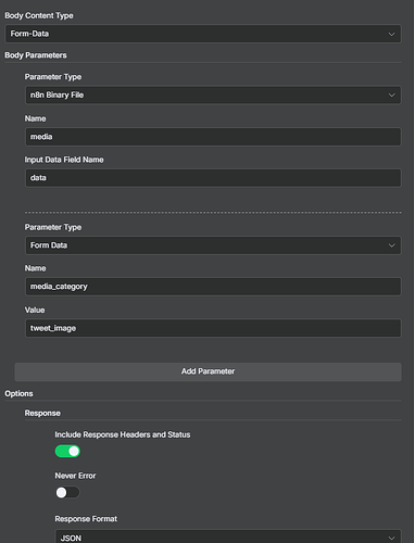

Here is the updated request node for new API endpoint
You can have a try to see if it can upload or not.

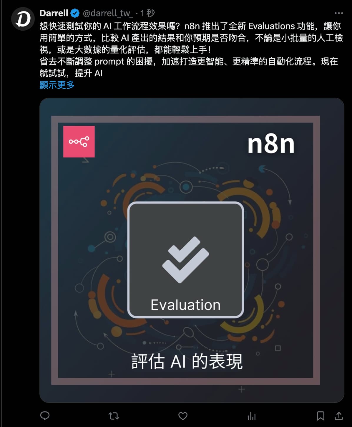

My test result is good :
