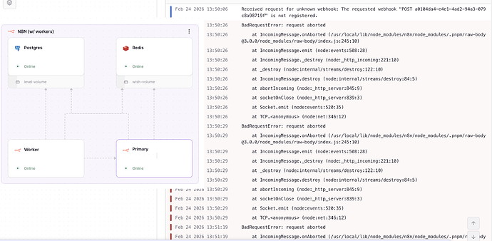

I’m facing a critical issue that started yesterday without any changes to my infrastructure. My n8n UI keeps showing the “Offline” message and I’m being spammed with BadRequestError: request aborted errors in the logs.
  • The UI is unstable and goes “Offline” every few seconds while working on workflows.
  • The Primary node logs are filled with the error below.
  • This is not a browser/extension issue (reproducible across environments).
